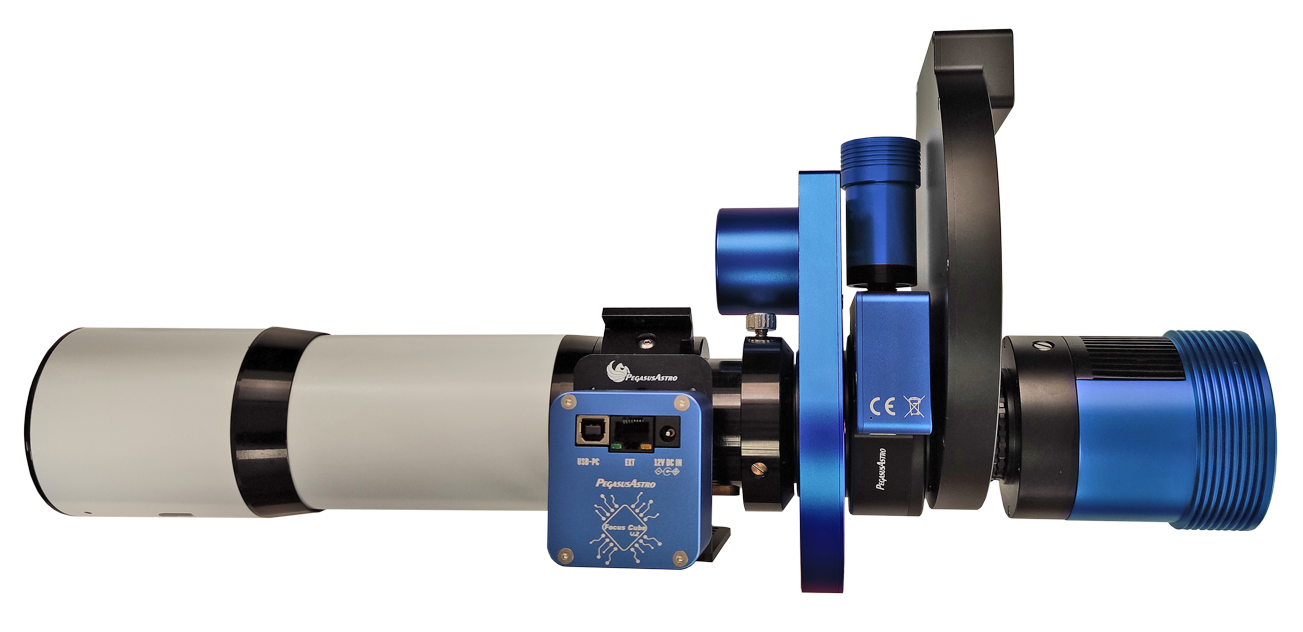

Lifts more than 6kg (13 lbs) of imaging equipment
when telescope point to zenith
FocusCube has a very low backlash and high torque suitable to focus in micron scale.
Due to its high resolution and torque, the FocusCube should be placed on the coarse knob / direct shaft of your telescope focuser

Designed in a high-quality CNC body with modern electronics, FocusCube provides digital precise focus control, for absolute position focusing.
Solid motor couplers in package
Six solid, different bore size, motor couplers are provided so you can select the coupler that fits to your focuser’s shaft. Choose between 3mm to 8mm couplers

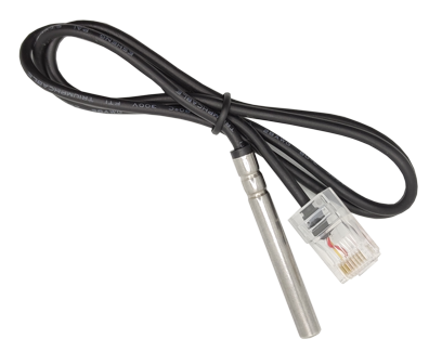

Temperature Probe
An external digital temperature sensor input is located on the side of the focuser. A digital temperature sensor is included in the package. The probe can be placed near the focuser so the exact temperature of the focuser / environment can be seen through the supplied software or ASCOM driver.
