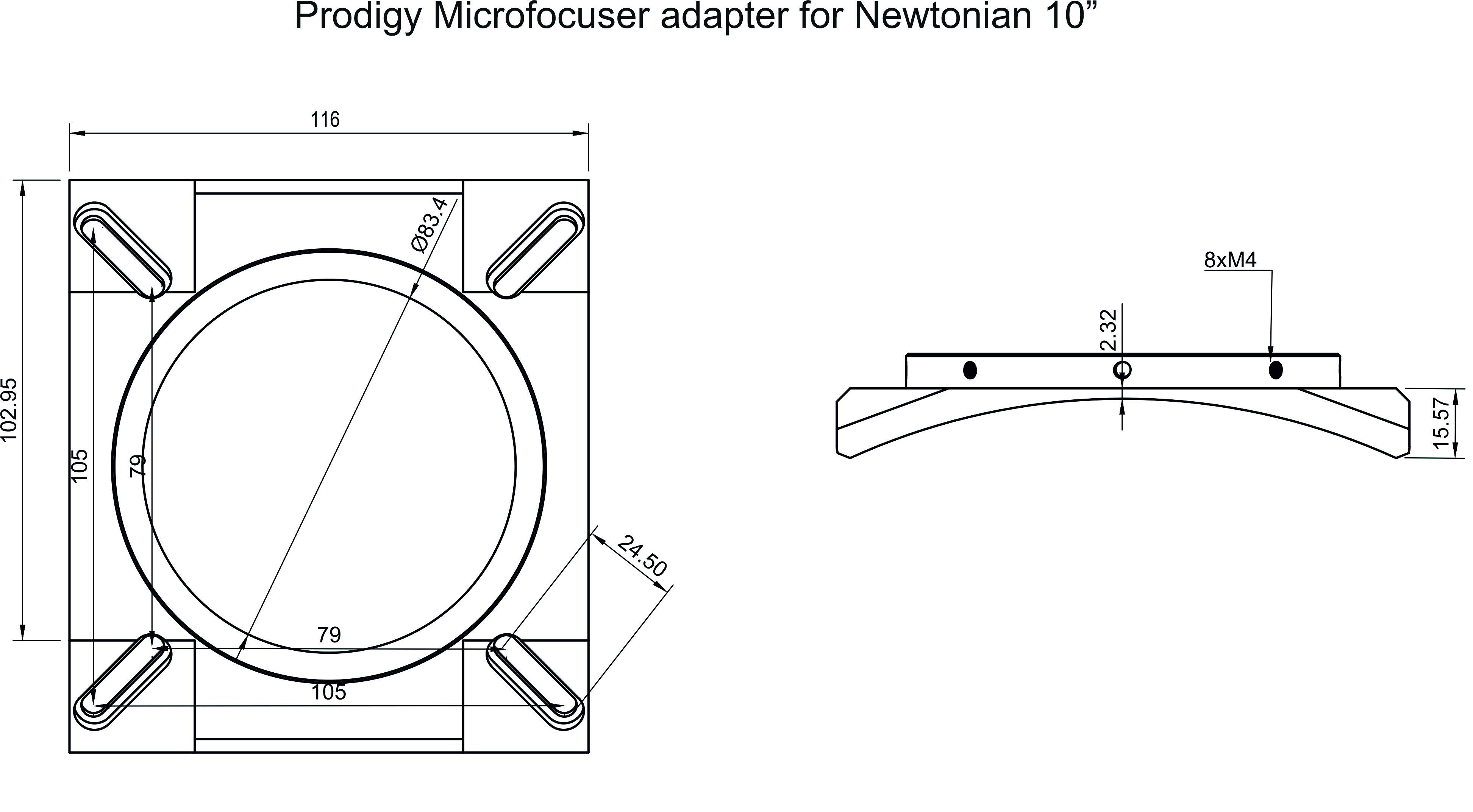

Newtonian 10-inch (SKU: PEG-PRDG-NEWT10)
Mechanical Drawing
Newtonian 12-inch (SKU: PEG-PRDG-NEWT12)
Mechanical Drawing
