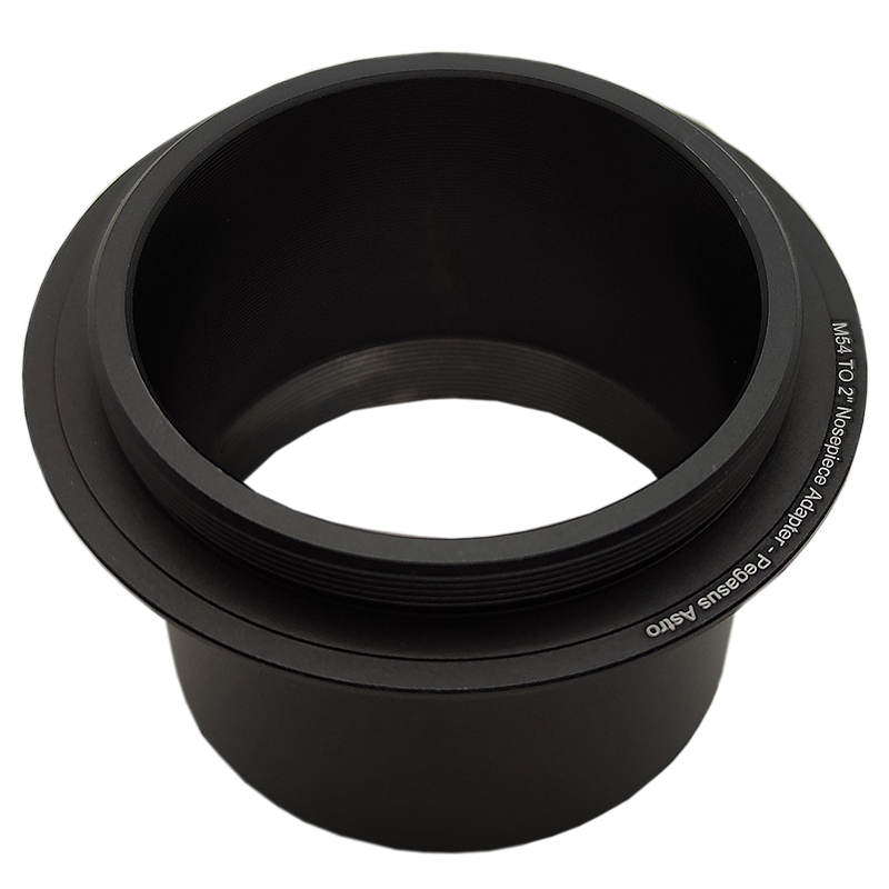

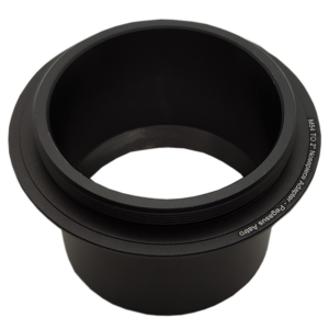

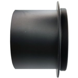

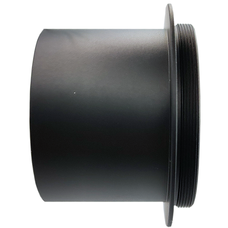

M54 Male to 2” Nosepiece (inner hole with 2” filter thread)
SKU: PEG-ADAPT-M54M-2NP
- Total Nosepiece Length :35mm
- Adapter Thickness : 1.5mm
- Thread: Pitch 0.75mm / 4 mm length
- Includes inner hole for 2” filter thread (M48)

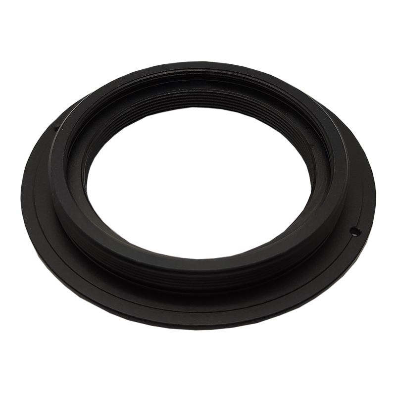

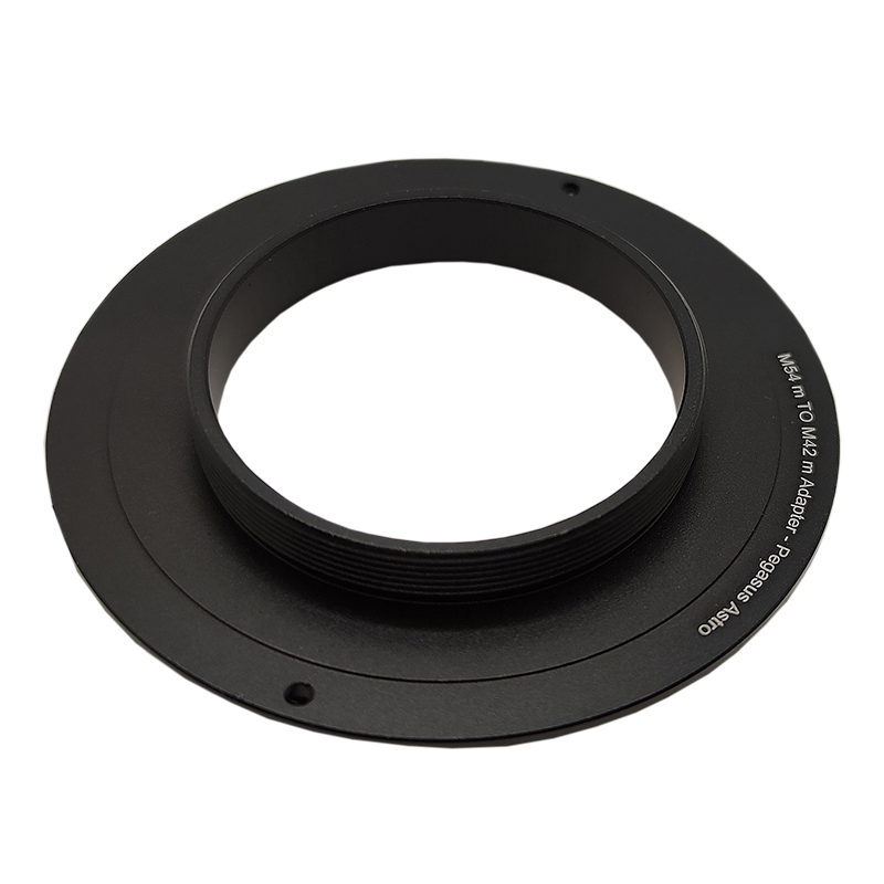

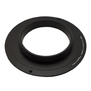

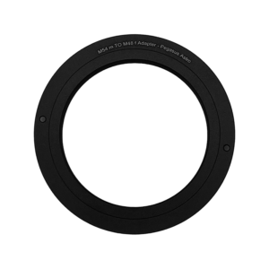

M54 Male to M42 Female
SKU: PEG-ADAPT-M54M-M42F
- Adapter Thickness: 2.0mm
- M54 side has a M48 internal thread

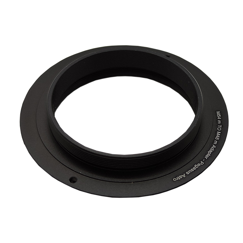

M54 Male to M48 Male
SKU: PEG-ADAPT-M54M-M48M

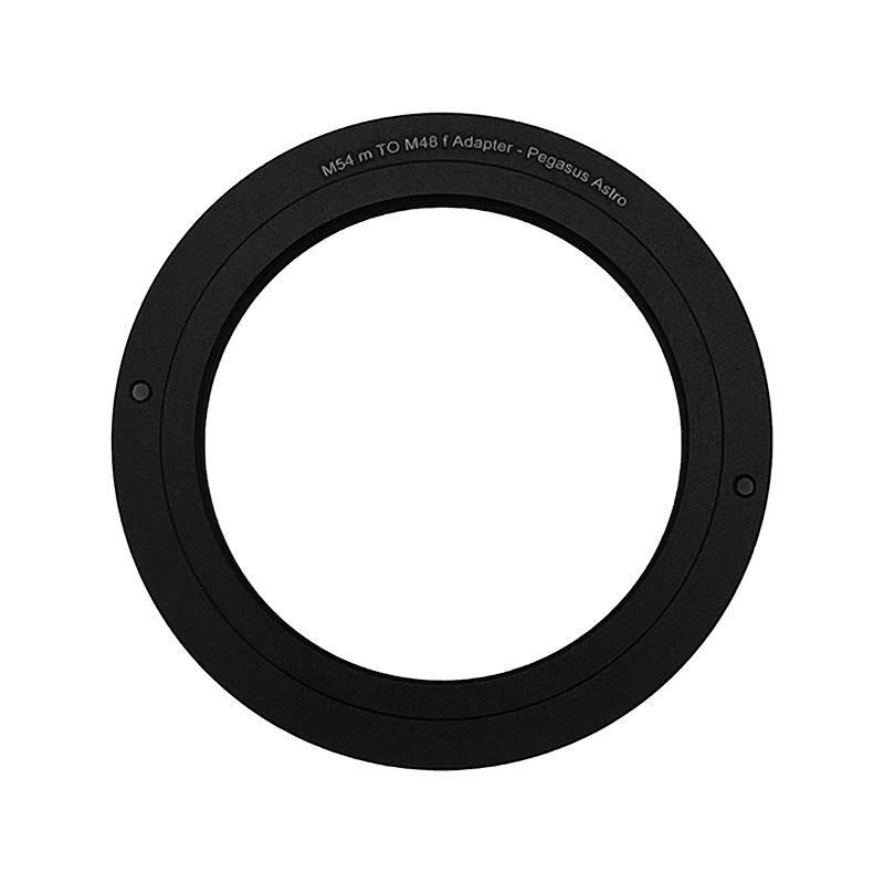

M54 Male to M48 Female
SKU: PEG-ADAPT-M54M-M48F

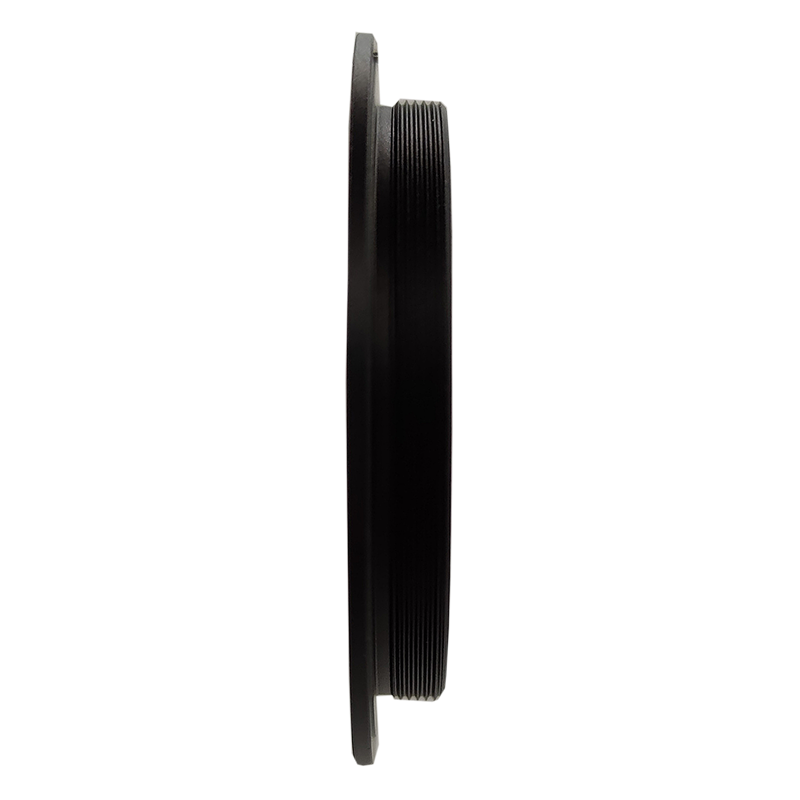

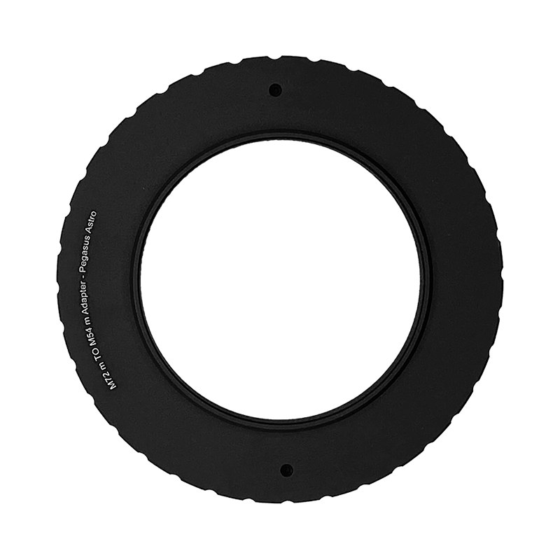

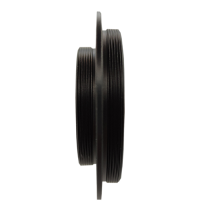

M72 Male (Takahashi thread) to M54 Male
SKU: PEG-ADAPT-M72M-M54M
- Adapter Thickness: 8.0mm
- Thread M72 Takahashi: Pitch 1.0mm / 4 mm length
- Thread: M54 Pitch 0.75mm / 4 mm length

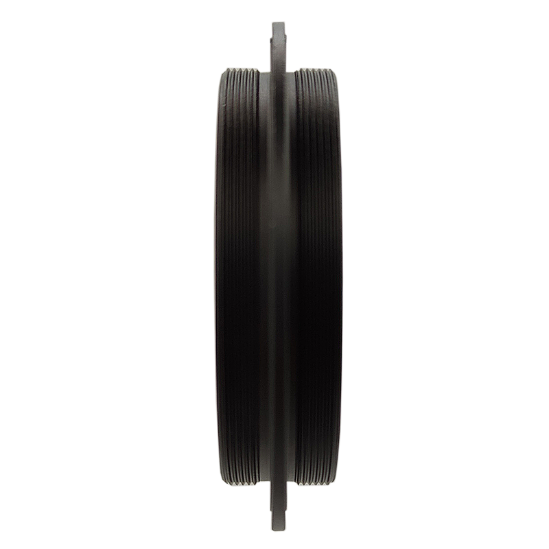

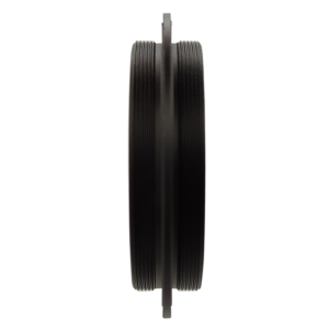

M54 Male to M54 Male (inner hole with M48)
SKU: PEG-ADAPT-M54M-M54M

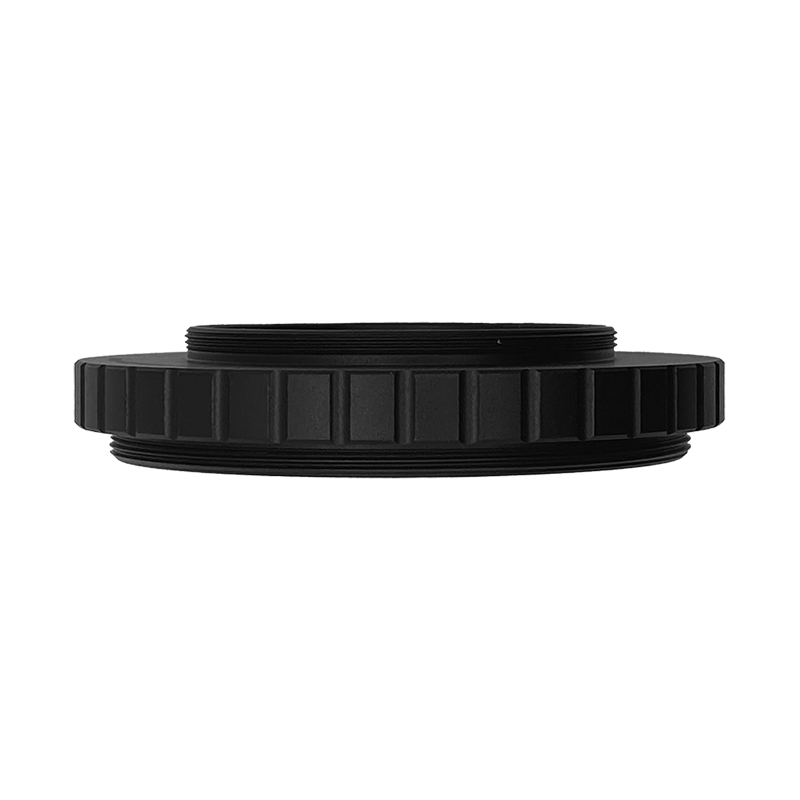

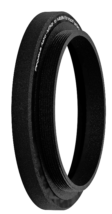

M66 Female to M54 Male (For SW Esprit 100)
SKU: PEG-ADAPT-M66F-M54M
- Thread: Pitch M66/1.0mm, M54/0.75mm
- Connects SW Esprit 100 Flatenner with any M54 threaded accessories
SW Esprit 100 + PEG-ADAPT-M66F-M54M + Pegasus Astro Indigo OAG + Pegasus Astro Indigo Filter Wheel + QHY268M Camera = 63mm optimal backfocus distance
