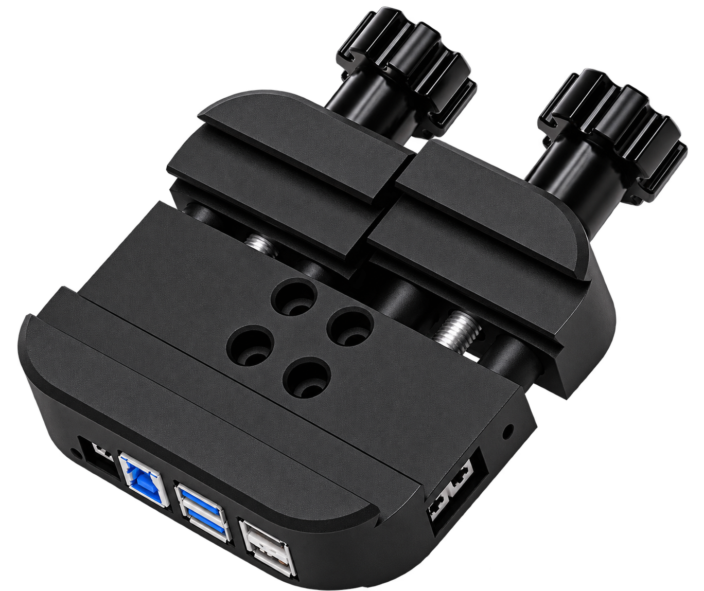

Built-in USB3.1 Hub – 2 x USB3 & 2 x USB2 Ports
A powered MTT (Multi Transaction Translator) USB3 Hub at the back of the device provides:
- 2 x USB3 SuperSpeed Ports.
- 2 x USB2 High-Speed Ports.
The new SuperSpeed hubs operate in parallel with the USB 2.0 controller, so 5 Gbps SuperSpeed data transfers are not affected by slower USB 2.0 traffic.

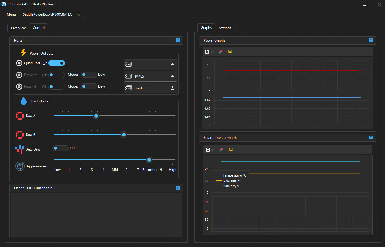

Two Pulse width modulation (PWM) outlets are capable to provide power to your “thirsty” Dew Heaters. No more moisture fuzzing your equipment and destroying your clear nights. These outlets can be remote-controlled from your laptop using the supplied software.
Auto Adjustment of
PWM (Dew Outputs)
Controller can auto adjust the heater power levels by consulting the environmental sensor Dew Point reading. Just click “Auto” and leave to Powerbox to decide if it is time to turn on and precise tune the level of your dew heaters.

Lonsmandy and Vixen Style support
A high-quality robust CNC aluminium saddle houses the electronics of the Powerbox.
The Saddle Powerbox is compatible with both Losmandy 3” and Vixen Clamp mounting systems, providing you with versatile options for securing and integrating your equipment.
Two separate and adjustable knobs provide you with precise control to securely fasten your telescope and gear, ensuring stability and ease of use.
ASCOM 6 Fully supported
Pocket Powerbox Advance fully supports ASCOM6. In combination with our main program which acts as a server you can use our latest ASCOM 6.5 supplied drivers to:
- Report environmental settings to supported software (e.g NINA / SGPro / MaximDL etc) (ASCOM ObservingConditions)
- Switch ON / OFF 12V outputs, tune Dew Heaters, Monitor Voltage, Current, Power. (ASCOM Switches)
