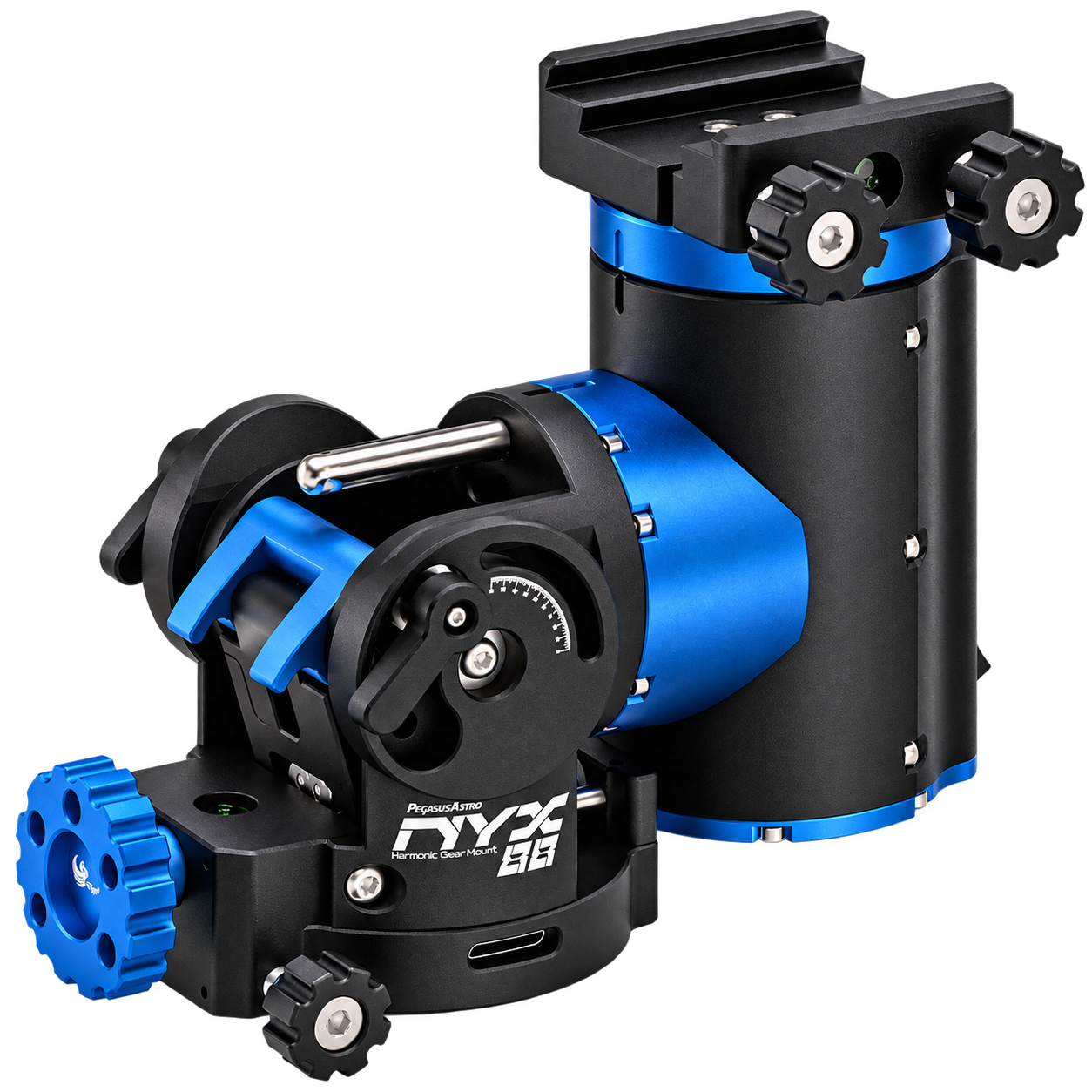

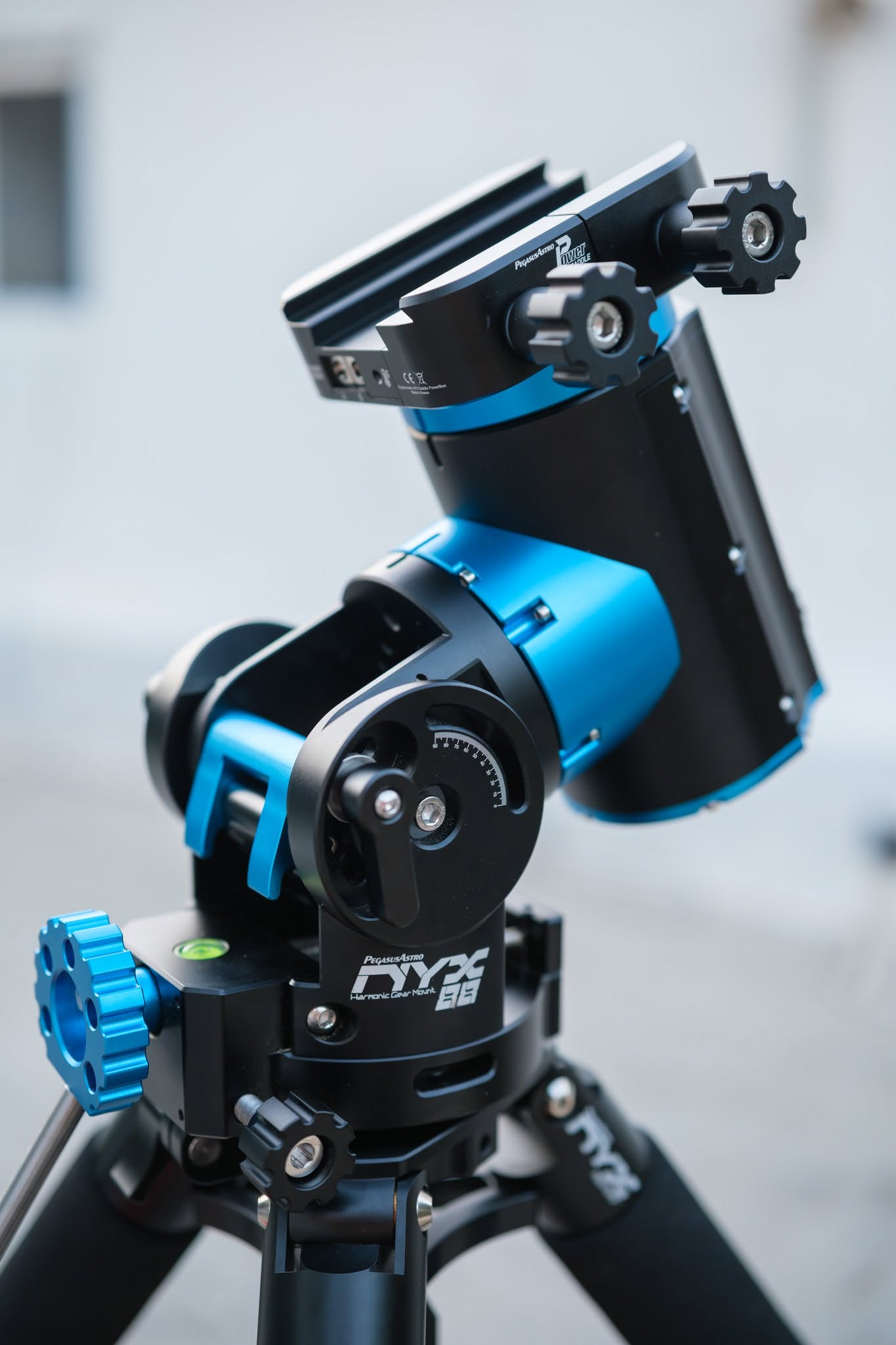

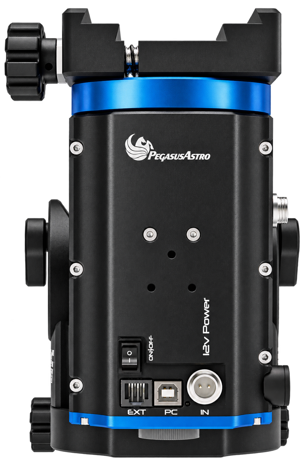

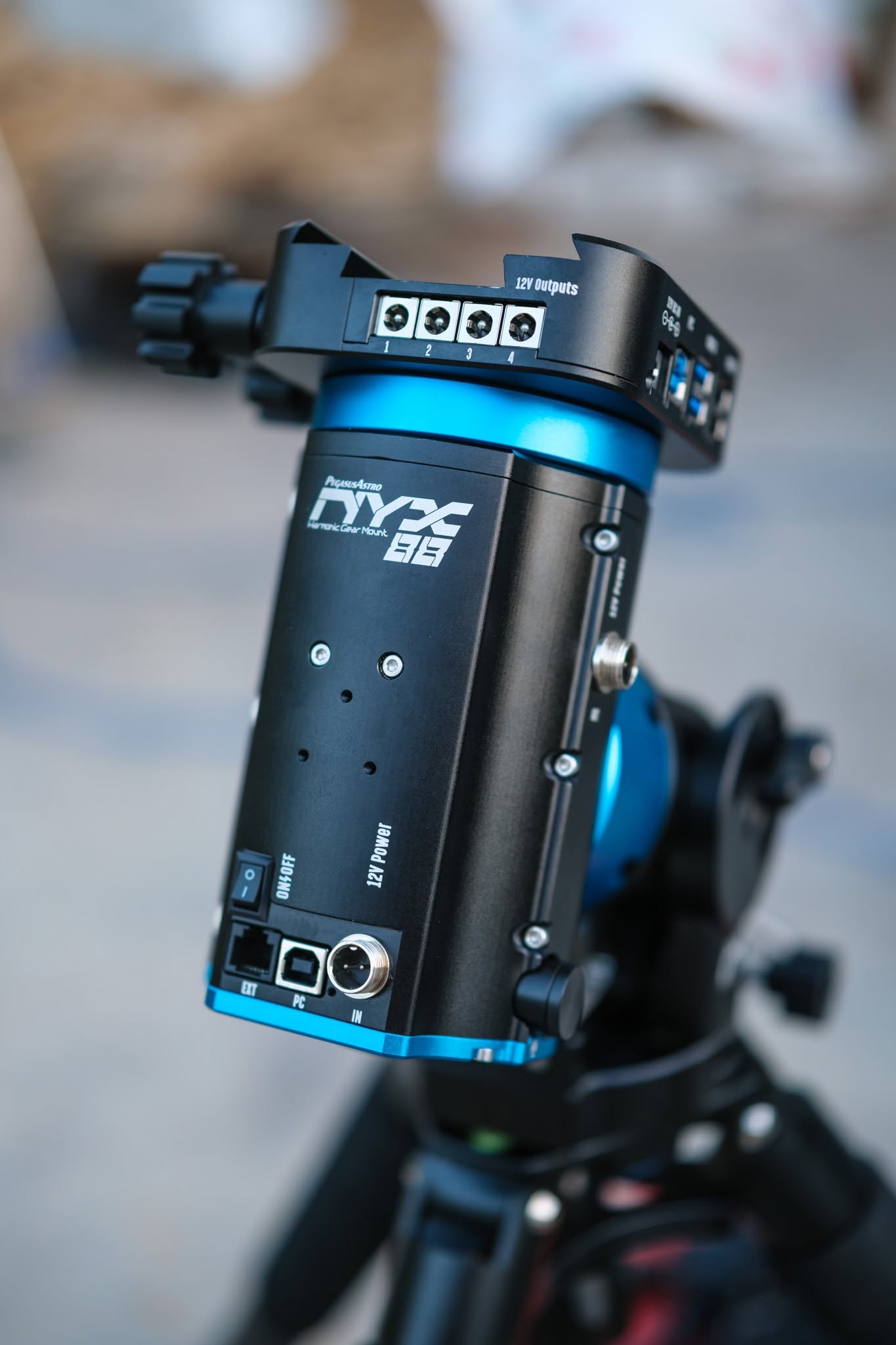

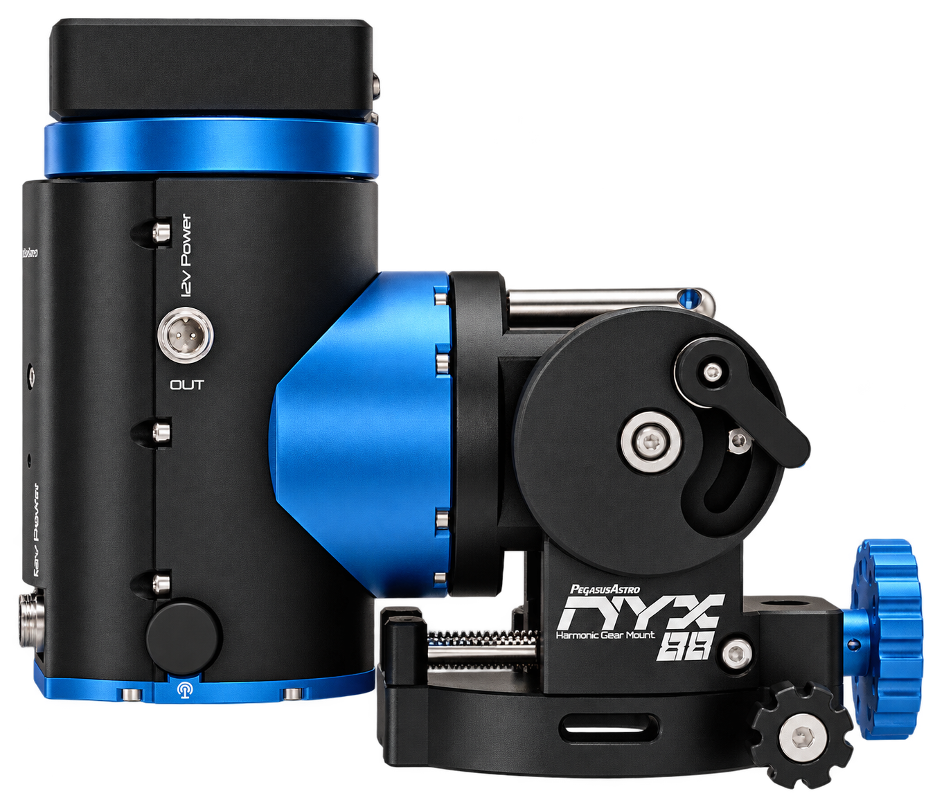

We’re excited to unveil the latest addition to our NYX harmonic mount series: the NYX-88, a compact mount designed to complement its larger sibling, the NYX-101.
The NYX-88, designed with travelers in mind, offers an impressive payload capacity of up to 14 kg (mount weighs 5 kg) without the need for counterweights. Engineered for precision and performance in astrophotography and observational astronomy, this mount ensures seamless and reliable operation.
Featuring strain wave drives on both the RA and DEC movements, the NYX-88 guarantees a backlash-free experience with high torque even at maximum payloads. Its fully CNC machined aluminum alloy 6061 body, anodized in black and blue, combines durability with aesthetics. Inside, you’ll find top-quality branded components, including stepper motors and strain wave gears, ensuring the mount’s long-term flawless performance.
The mount also includes an electronic brake on the RA axis to prevent backsliding when the power is off, as well as safety limit stops during slewing or tracking. Whether you’re exploring the night sky from your backyard or a remote location, the NYX-88 is the perfect companion for travelers seeking precision and reliability in their astronomical pursuits.

High precision strain wave gears
Harmonic Gears on Both Axis ensure high payload capacity and a smooth backlash-free operation.
Combining a stepper motor and belt drive with sophisticated electronics, the RA axis achieves a remarkable 0.15 arcseconds of resolution, offering very low periodic error for ultra-smooth and stable tracking down to subarcsecond accuracy.

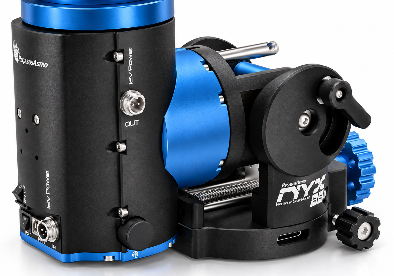

Secure DC Output
An extra DC (GX-12) output on the side of the mount provides up to 8A to your equipment.

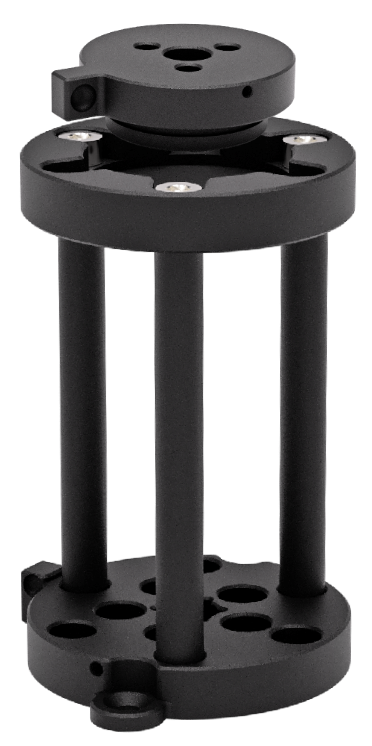

Half Pier – For Carbon Tripod
SKU: PEG-HP88-NYX-TRPD
A 18 cm (7”) pier extension includes all necessary adapters and 3 rods for assembly.
(The Half Pier supports up to 6 standoffs, with an option to purchase 3 additional rods separately. SKU: PEG-STDOFF-RODS).
This half pier is ideal for mounting the NYX88 on the Carbon Tripod (PEG-TRPD88).
The Half Pier is essential for preventing your telescope from colliding with the tripod legs.

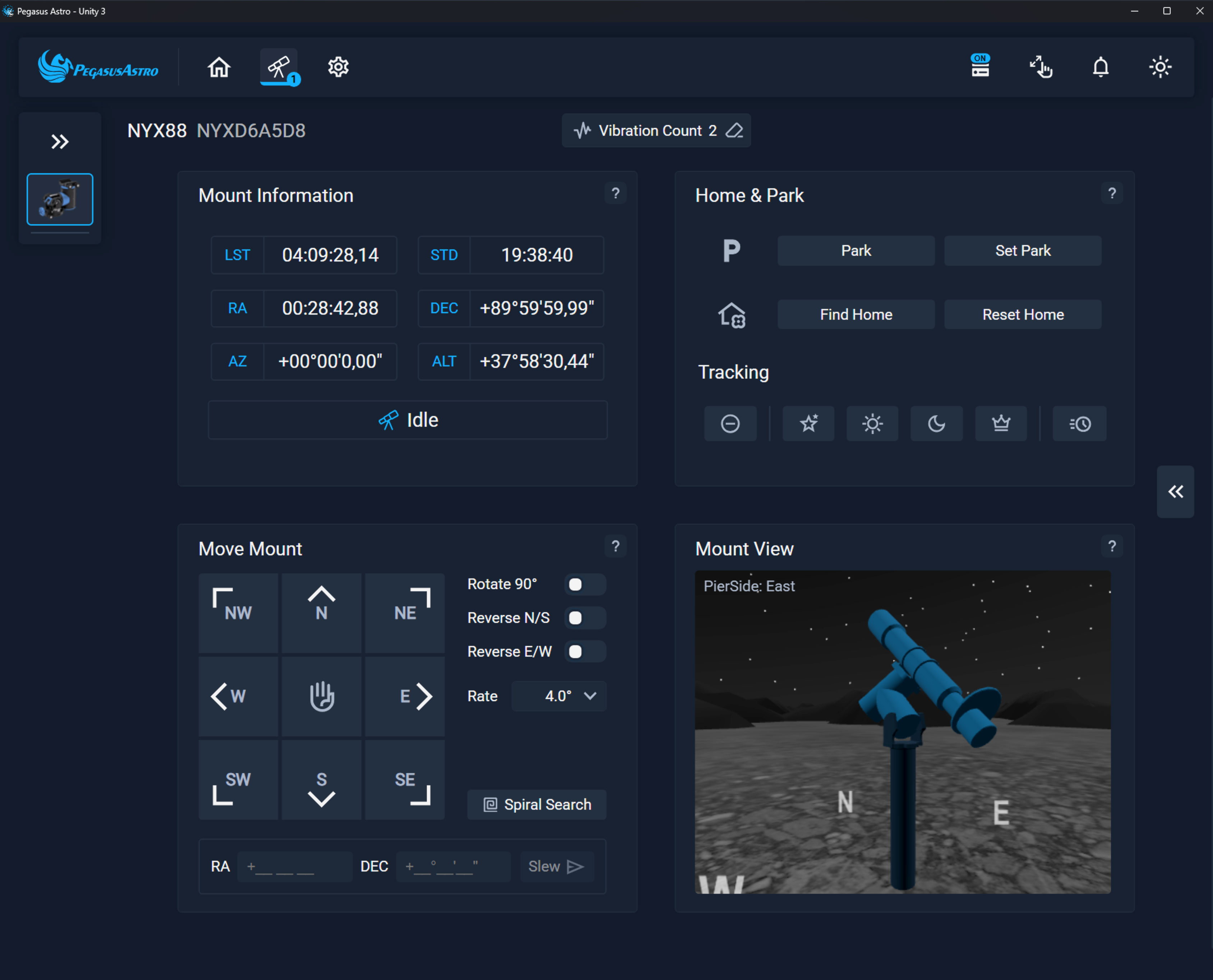

Unity Platform
NYX mounts are controlled and fully configured through our Unity Platform via USB or Wi-FI channel. The included ASCOM driver supports multiple clients.
