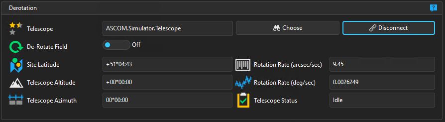

Field De-Rotation support for Alt-Az mounts
Rotator has the mechanical precision to achieve field de-rotation. Supplied Unity Platform calculates Rate of Rotation (RoR) based on the site latitude, target altitude and azimuth position.
By fine-tuning the micro-step drive control of the motor, derotation can achieve an resolution as precise as 5 arc-seconds.

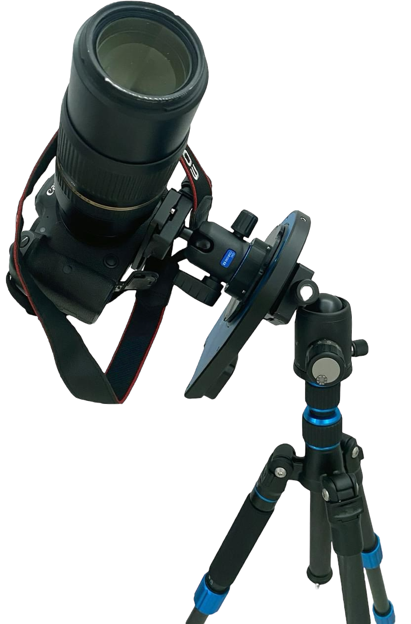

Star and Solar tracker support
Rotator Firmware (v1.3) now supports both sidereal and solar tracking, allowing you to mount the Falcon v2 rotator on a tripod, align it with the North or South Celestial Pole (NCP or SCP) and track the stars or sun.
Simply attach your camera with a telephoto lens (or a small refractor telescope) to the rotator for a mobile, grab-and-go solution.
Ideal for travelers seeking convenience and high portability, the Falcon2 rotator provides a swift and ultra-portable setup for your equipment.
We are developing an AstroStat retrofit kit that integrates the Falcon2 rotator with your tripod, enhancing your stargazing experience with ease and precision.
