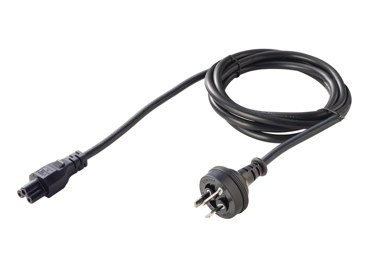

Our sealed and certified switching power supply unit is the perfect match for our Pegasus Astro Products. It can provide 12V and up to 10Amps. (120W of total power). Low ripple and noise ensures that you will provide the required and correct “electric juice” to your precious equipment. Comes together with a power cord (1.5m) for your country type.
Please notice there are three (3) types of DC Cords (Choose wisely!)
Available Country Power Cords
