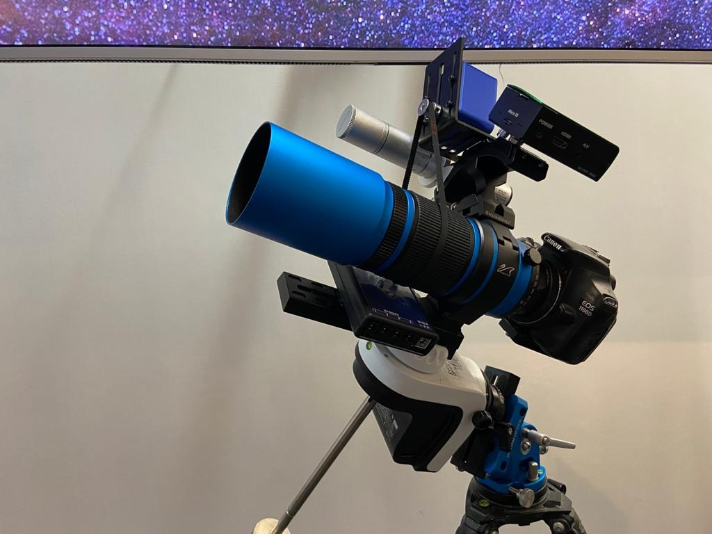

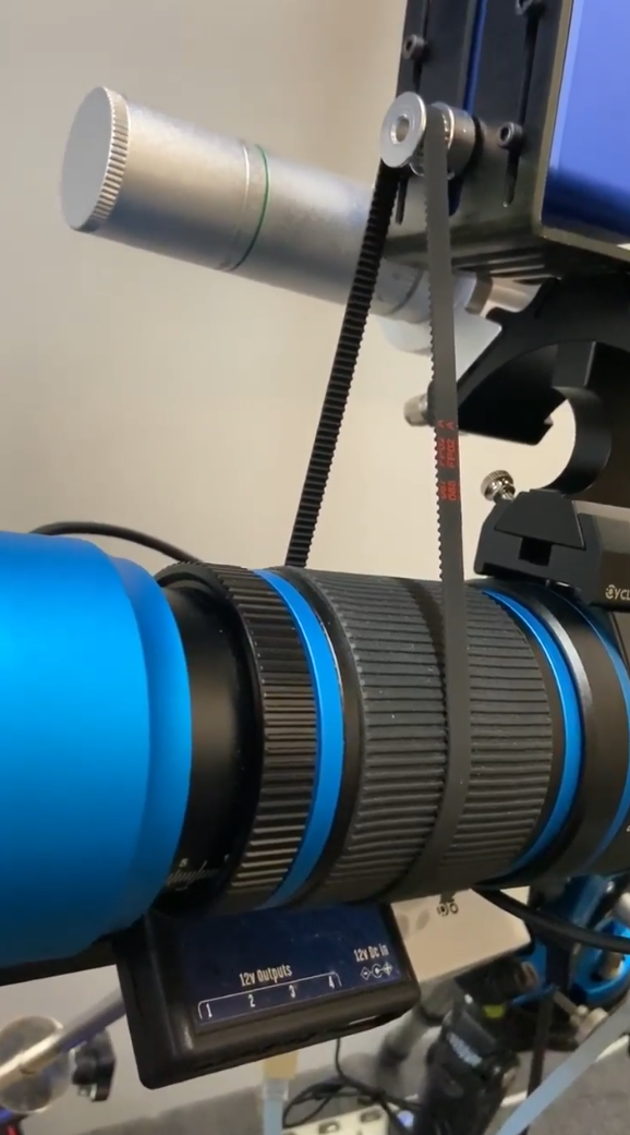

You will need the PEG-LENS-KIT which consists of a set of pulleys and a belt.
Then you can use the FocusCube v2 in combination with the Lens Kit to focus the WO Redcat.
