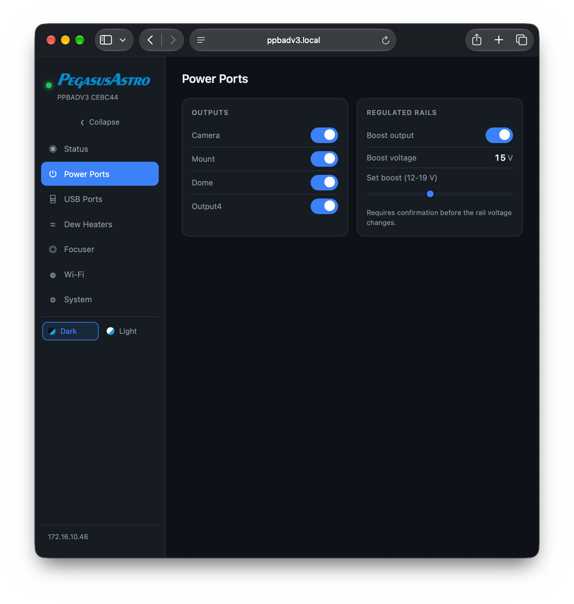

Four independently switchable 12V DC power outputs let you control your entire astrophotography setup through Pegasus Astro software, ASCOM, Alpaca, or the built-in web interface. Each output features reverse polarity and over-current protection for reliable operation. An always-on 12V output and a software-adjustable 3–19V output bring the total number of power ports to six.

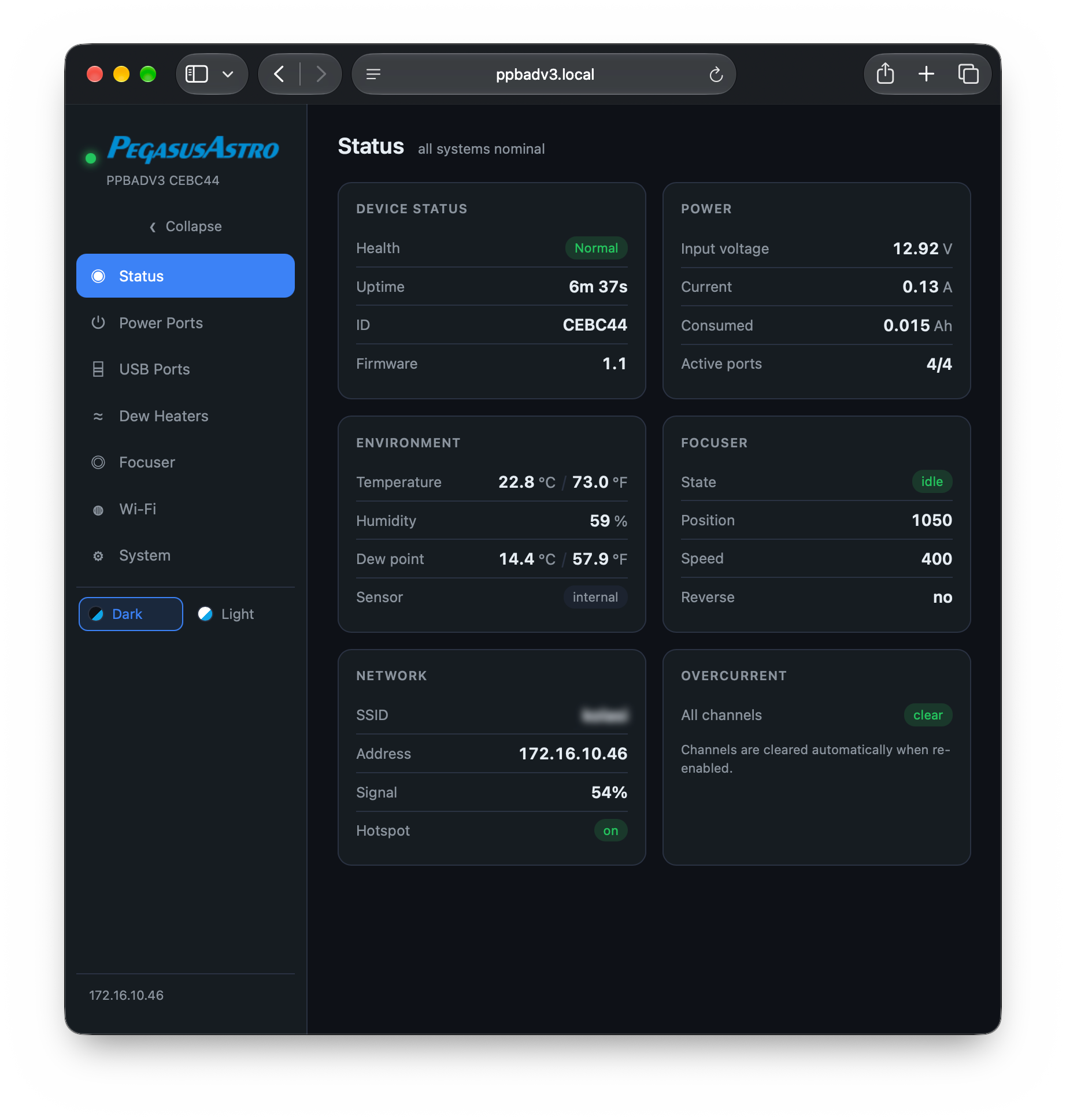

Includes a built-in volt, current, and power meter that continuously monitors your power input and overall system consumption in real time. Instantly view the input voltage, total current draw, and power usage through the Pegasus Astro software, ASCOM/Alpaca drivers, or the built-in web dashboard. This allows you to monitor your equipment’s power requirements, quickly identify abnormal consumption, and ensure stable operation throughout your imaging sessions.
Env Sensors
The PPB ADV Gen3 includes an external temperature, humidity, and dew point sensor in the box, providing accurate real-time environmental monitoring. When used with the integrated dew heater outputs, the device can automatically regulate heater power based on ambient conditions, preventing dew and moisture from forming on your telescope optics while minimizing unnecessary power consumption.

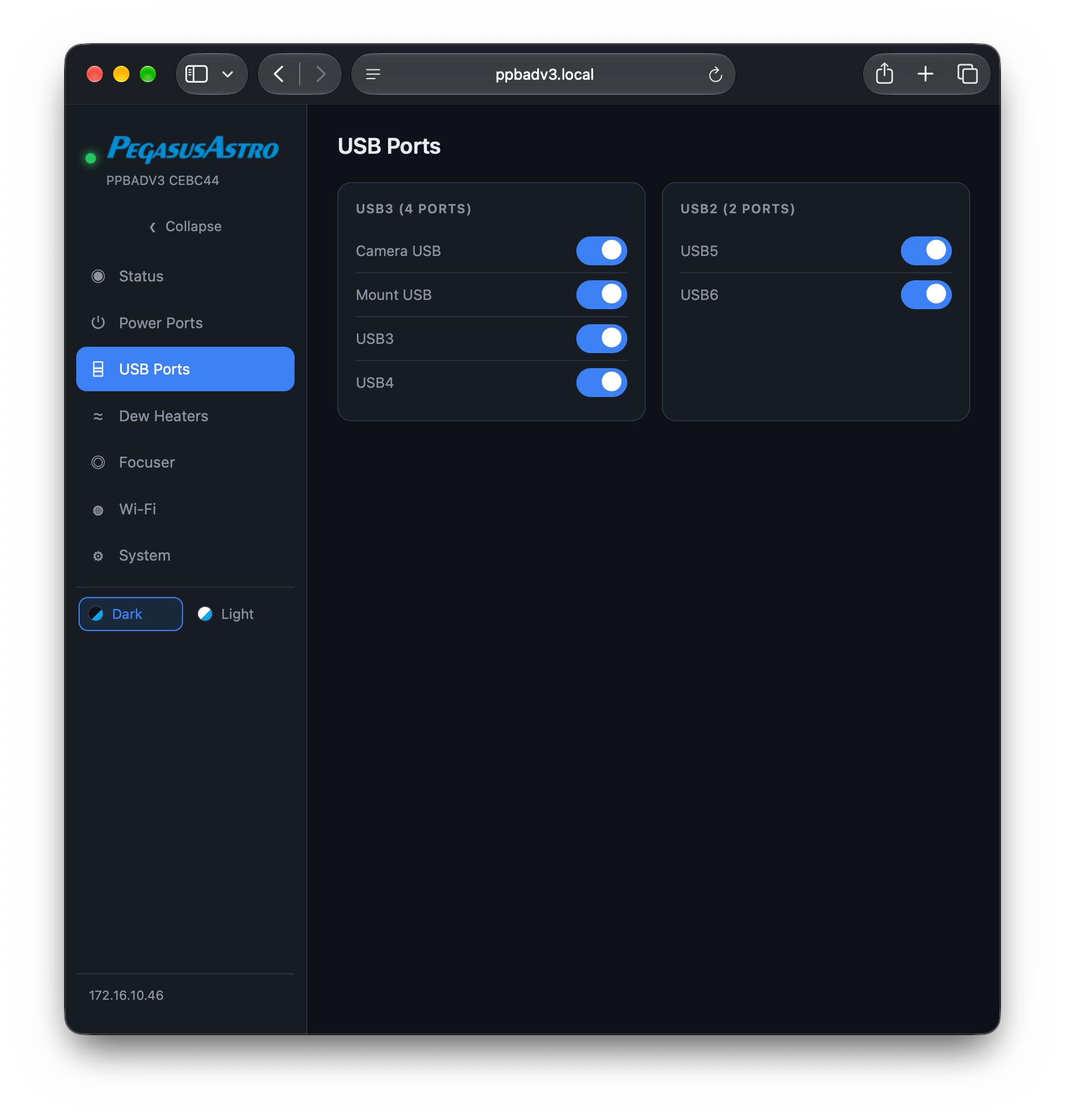

Built-in 6 port USB Hub
A powered USB3 Hub at the back of the device provides:
- 4 x USB3 (Type-A) SuperSpeed Ports
- 2 x USB2 (Type-C) High-Speed Ports.
The new SuperSpeed hubs operate in parallel with the USB 2.0 controller, so 5 Gbps SuperSpeed data transfers are not affected by slower USB 2.0 traffic.
USB Ports provide up to 3Amp of current and all ports include surge and ESD protection.

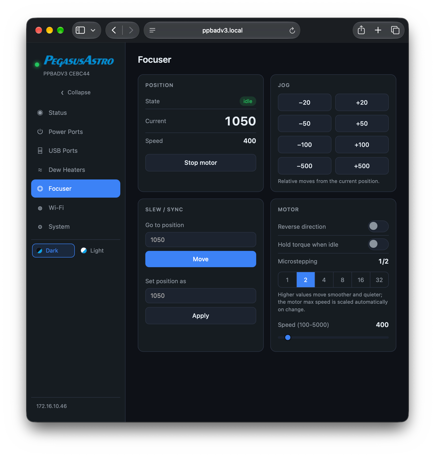

The PPB ADV Gen3 features a built-in stepper motor focus controller, eliminating the need for a separate external focusing controller and reducing cable clutter.
Compatible with most bipolar stepper motors (we recommend our Motor Focus Kit Universal or Motor Focus Kit Zero for SCT telescopes. it delivers smooth, precise, and repeatable electronic focusing with up to 1.5A per coil. By requiring only an external motor, it offers a significantly lower-cost focusing solution while allowing you to control both power distribution and focusing through the same Pegasus Astro software interface.
Fully integrated with the Pegasus Astro software ecosystem, ASCOM, and ASCOM Alpaca, it supports automated focusing routines in popular astrophotography applications, helping you achieve and maintain critical focus throughout your imaging session.

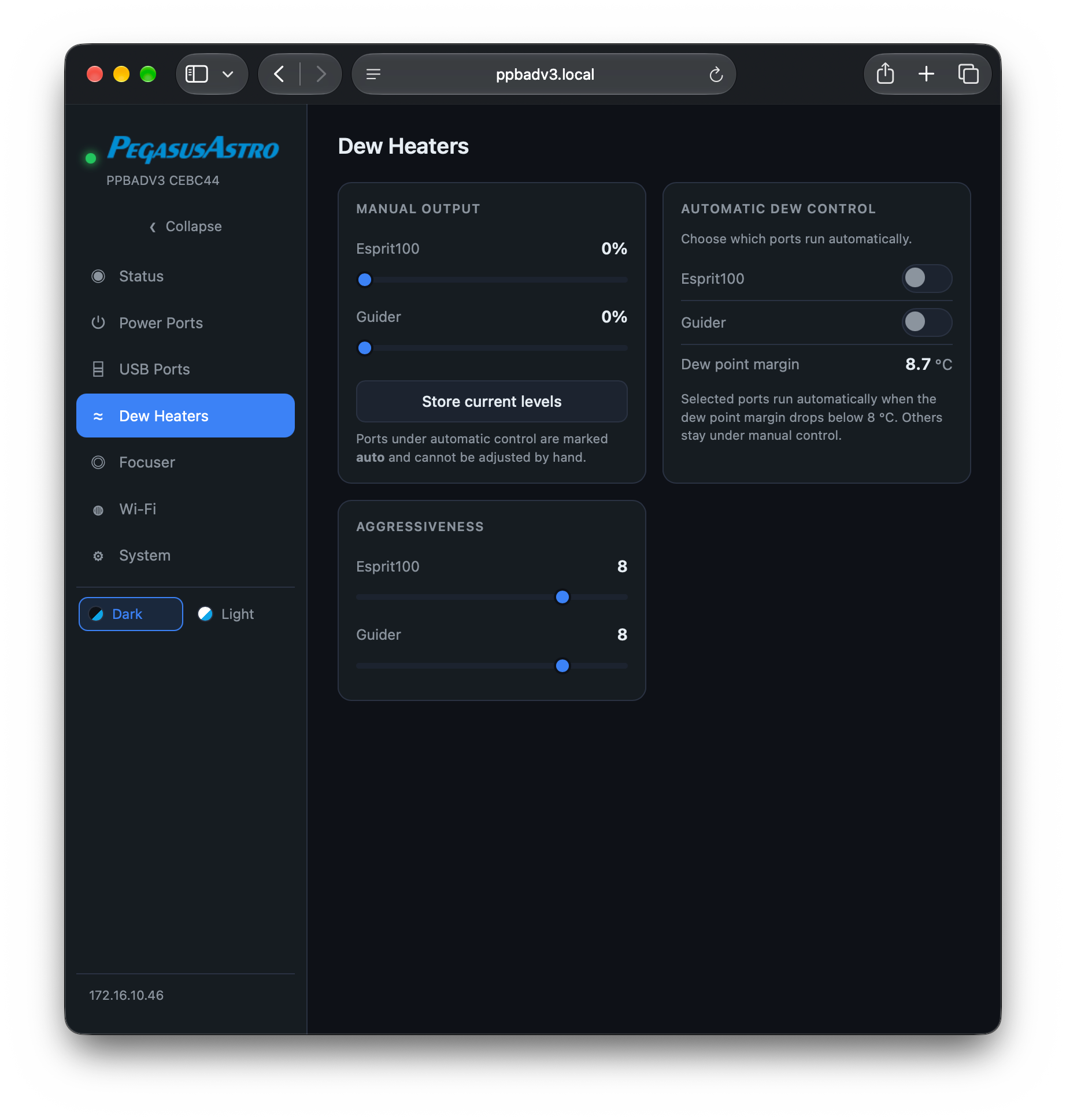

The Pocket Powerbox Advance boasts two Pulse Width Modulation (PWM) outlets, specially designed to supply power to your demanding Dew Heaters. This means an end to the woes of moisture interfering with your equipment and spoiling those precious clear nights. What’s more, you can conveniently control these outlets remotely from your laptop using the provided software.
Auto Adjustment of
PWM (Dew Outputs)
The controller is equipped with an intelligent feature that allows it to autonomously adjust the power levels of your heaters by analyzing data from the environmental sensor, specifically the Dew Point reading. With a simple click on the “Auto” function, you can entrust the Pocket Powerbox Advance to determine the optimal time to activate and precisely fine-tune your dew heaters.

Adjustable port configurable [3-19V]
One adjustable DC output (3–19 V, up to 3 A) configurable through software. The configured voltage is retained across power cycles and is perfect for powering Mini PCs, Intel® NUCs, and other external devices.

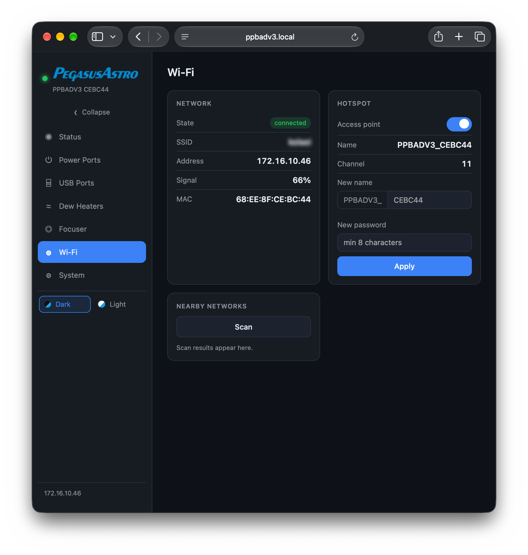

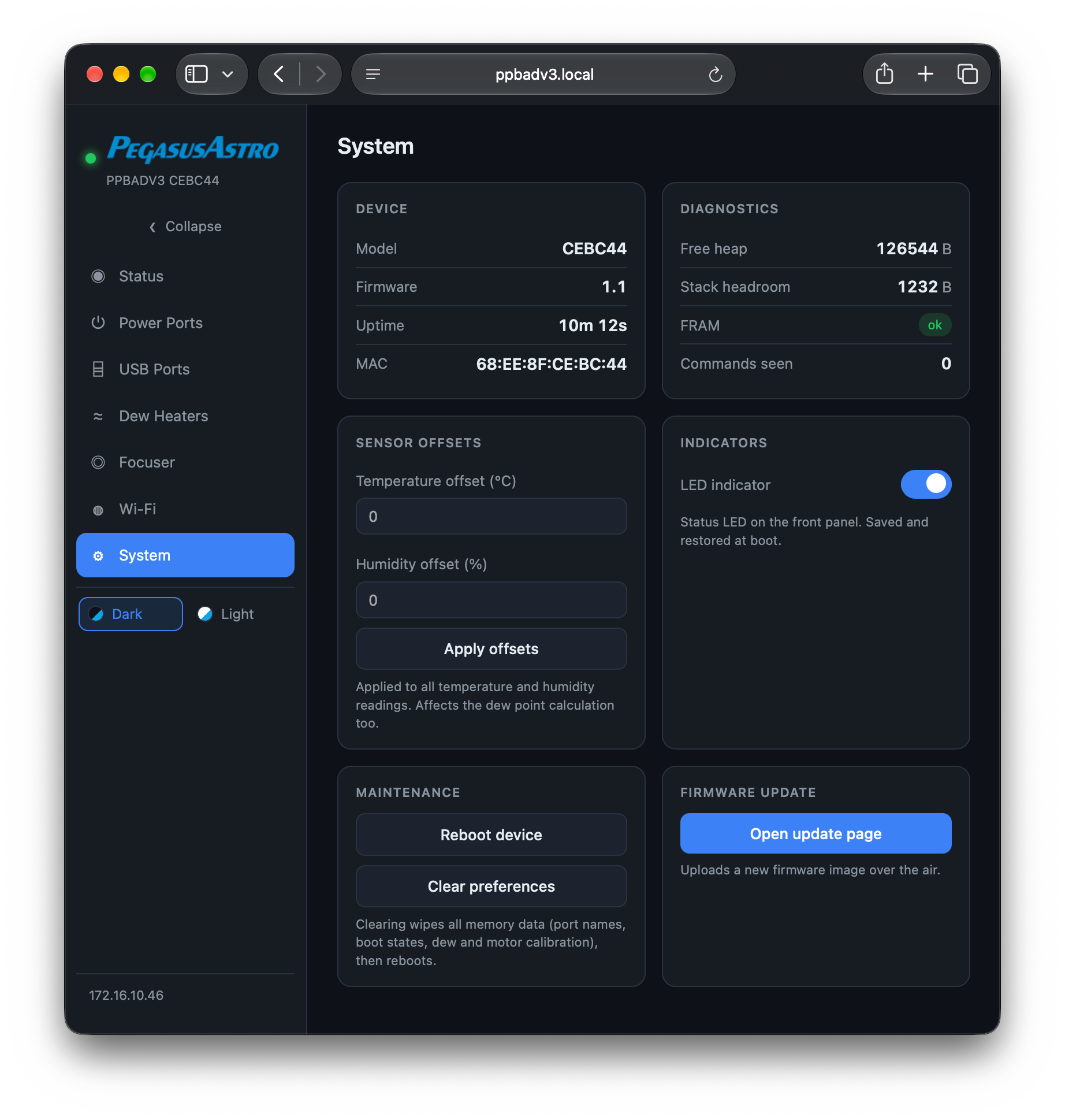

Stay connected with built-in Wi-Fi and a browser-based dashboard. The PPBADV Gen3 is fully compatible with ASCOM 7 and ASCOM Alpaca, enabling seamless remote control of switches, focuser, and observing conditions.

Web Dashboard and ASCOM Alpaca
Control the Pocket Powerbox Advance Gen3 from any device using a modern web browser – no dedicated software required. For astronomy applications, built-in ASCOM Alpaca support enables direct connectivity with NINA and any other Alpaca-compatible software, providing seamless remote control and automation.
