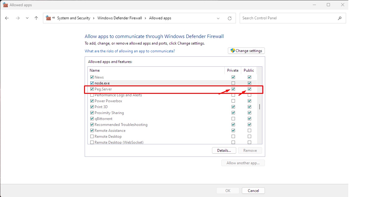

# is used for LX200 protocol and cannot be used inside an ssid or password. - Windows Firewall / Defender or any other anti-malware software that controls network access lists. e.g MalwareBytes is temporarily disabled.

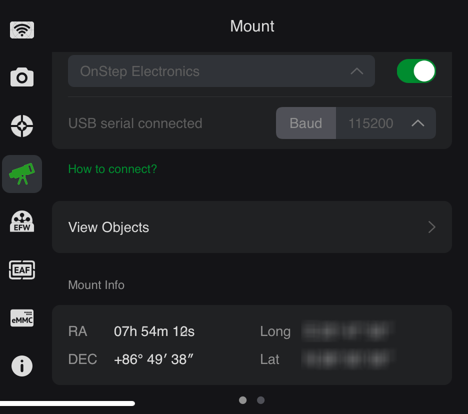

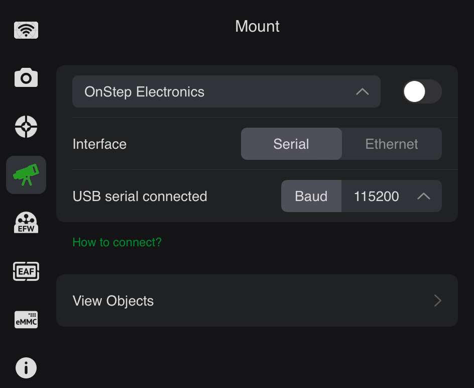

NYX-101 works with ASIAIR out of the box. Important functionalities of the mount can be easily controlled via USB cable connectivity and by selecting the “OnStep Electronics” driver.
Please note that we have provided a dedicated NYX-101 INDI driver but currently ZWO does not include it in the ASI AIR, so the OnStep Electronics” driver is a substitute for our official driver.
Select “Serial” and Baud Rate to “115200”
Connect to mount:

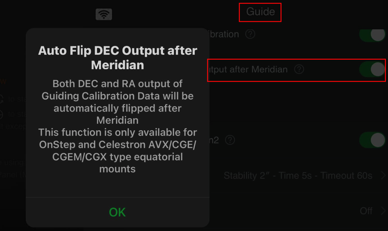

Make sure that you have enabled in Guide settings the “Auto Flip DEC Output After Meridian”.
You are ready to roll!

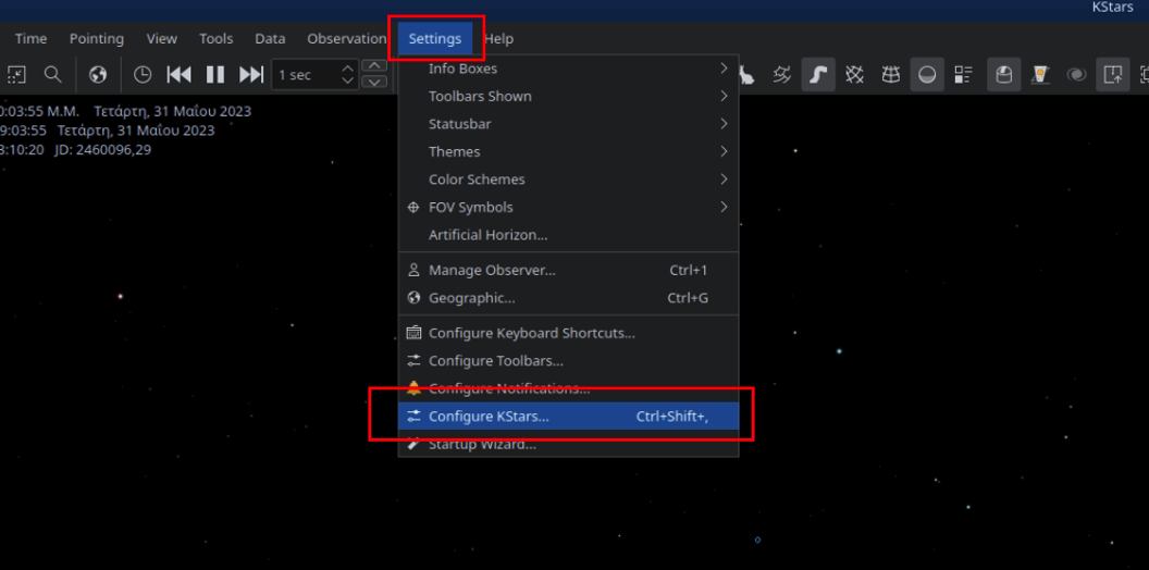

- On Kstars click Settings and select “Configure Kstars“

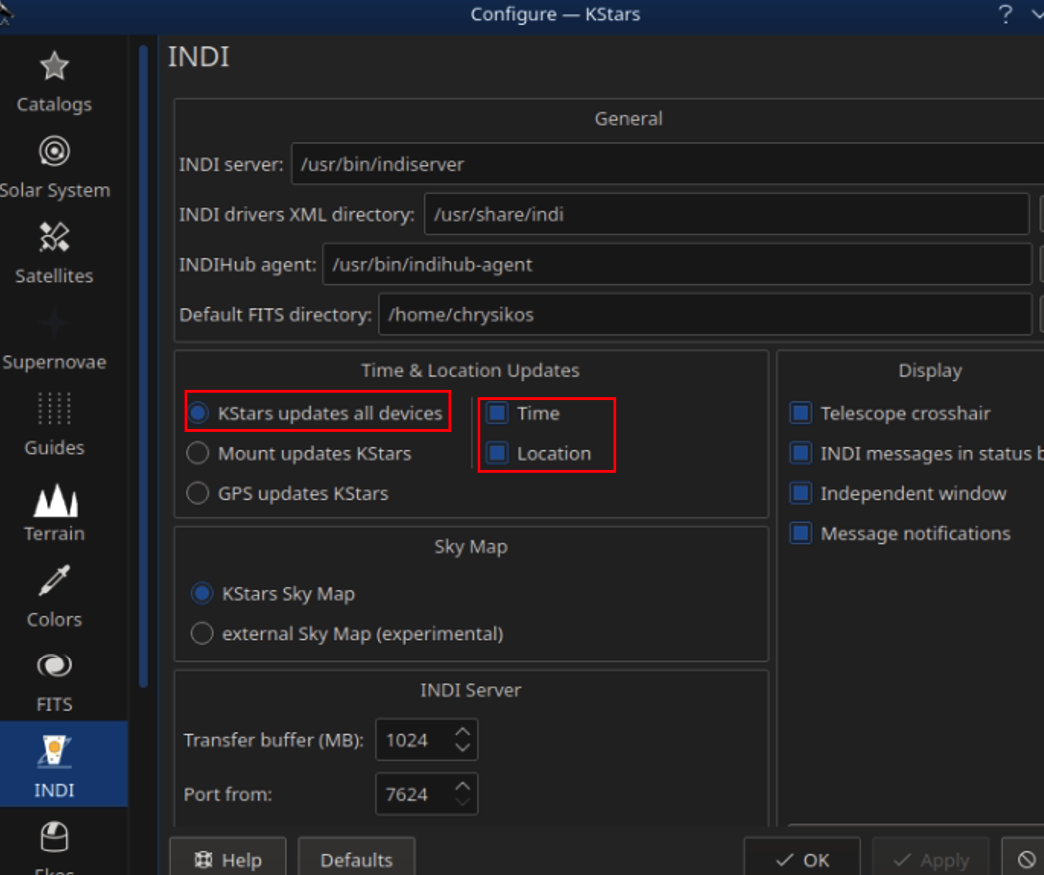

- Ensure that under INDI tab, you have checked Time and Location Updates. Tick Time, Location and Kstars updates all devices.

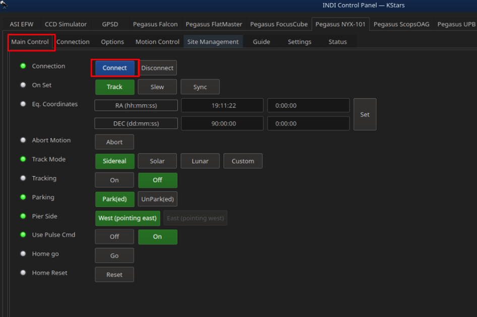

- Check Indilib drivers and locate “Pegasus NYX-101″ driver tab.
- Click Connect button.

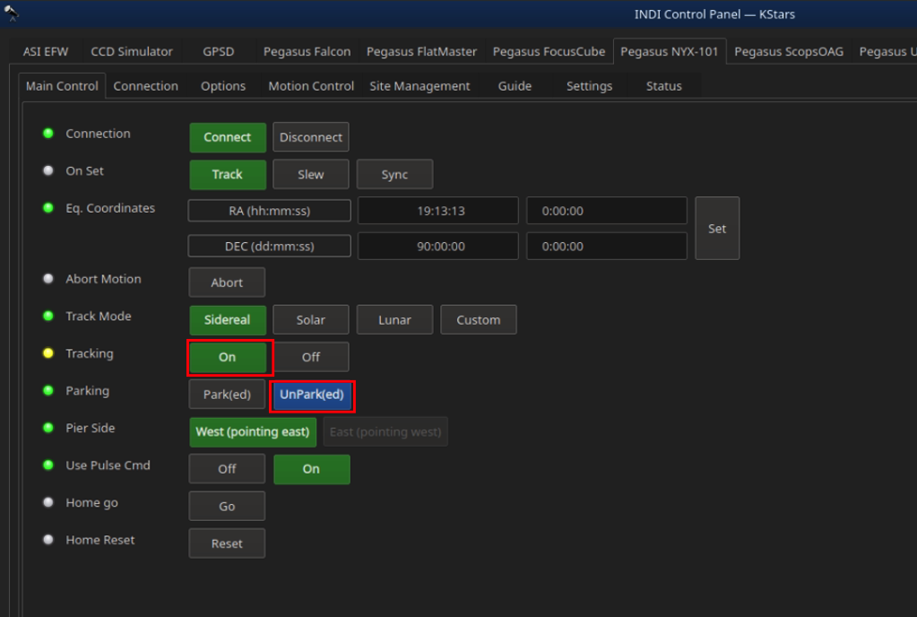

- Kstars will connect with the mount and list all available options.
- Click Tracking ON button or Unpark mount (if it is in park state) to unlock mount RA brake and operate the NYX-101 mount.
- The mount should have a valid site location, date, and time in order to be fully operational. If you encounter any issues ensure that these values have been pushed to mount. (Check Site Management tab).
- You are ready to go!
