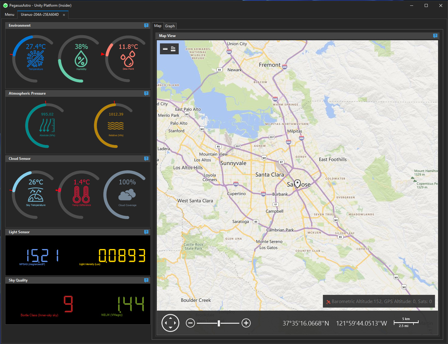

Unity Platform
Unity Platform allows monitoring and keeping a record of sensor data from day or night. Zoomable and exportable graphs keep a historic record of every observing session.

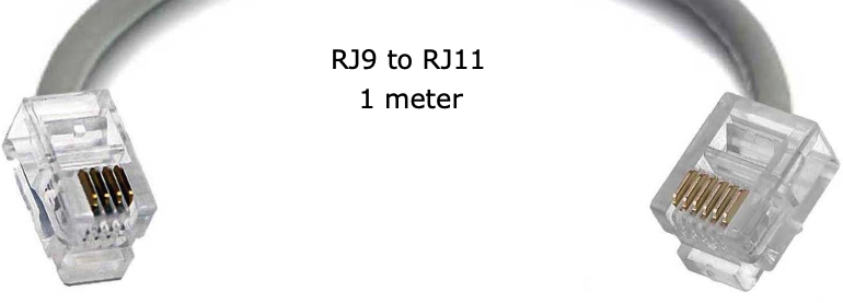

Uranus GPS Cord for 10Micron Mounts
This cable (RJ9 to RJ11) transmits GPS coordinates, altitude, ambient temperature and barometric pressure readouts to a 10Micron mount. Cable length is 1 meter.
