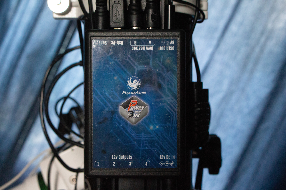

Pocket Powerbox (in short PPB) is suitable for the “grab and go” astrophotographer who does not want too much automation. Device can provide 10Amps of power, a sufficient number of 12V Outputs, Two Dew Heater Channels, A DSLR power output and an environmental sensor to monitor humidity and temperature.
The Pocket Powerbox provides:
![]() | 4 x 12V DC Power outlets for your equipment (ON/OFF via software) |
![]() | 10 Amps of total power |
![]() | DSLR 8V Output (Can be switched ON/OFF) |
![]() | 2 Channels PWM Dew Heaters – RCA Outputs (Tune levels via software) |
![]() | Humidity and Temperature Sensor (included) |
![]() | Auto Tune Dew Heaters |
![]() | Reverse Polarity Protection |
![]() | USB / PC Controlled or Standalone Operation out of the box |
![]() | Lightweight and extremely compact enclosure |

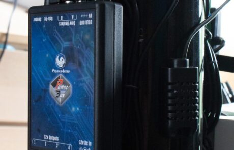

External Environmental Sensor
External one (1) meter temperature & relative humidity sensor is included in the package. Know exactly the environment conditions of your location. Temperature, humidity and dew point measurements are displayed in the software.
