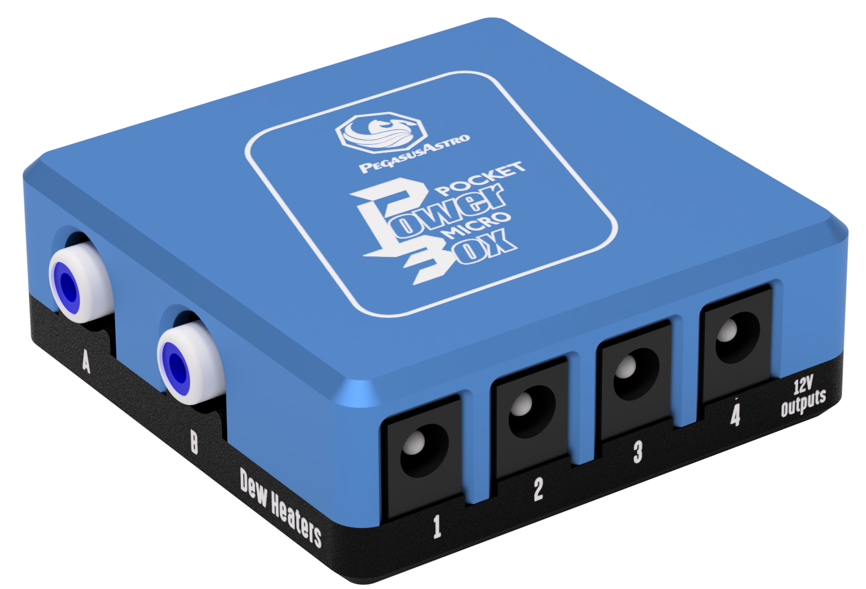

This small-sized device (in short PPB Micro) is suitable for the “grab and go” astrophotographer. It can provide up to 10Amps of power and has a sufficient number (4) of 12V Outputs, Two Dew Heater Channels, an adjustable voltage power output, and an environmental sensor to monitor humidity/temperature (dew point).
Pocket Powerbox Micro is the successor of the Pocket Powerbox
PPB Micro features:
  • 4 x 12V DC Power outlets for your equipment
    (ON/OFF via software)
  • 10 Amps of total power
  • A Voltage-Adjustable Output
    (Can be switched ON/OFF – 3V, 5V, 8V, 9V, 12V)
  • 2 x Channel PWM Dew Heaters – RCA Outputs
    (Adjust levels via software)
  • Humidity and Temperature Sensor (included)
  • Auto Tune Dew Heaters (Auto-Dew)
  • Reverse Polarity Protection, Overvoltage Protection
  • USB / PC Controlled or Standalone Operation out of the box
  • Lightweight and extremely compact CNC aluminium enclosure

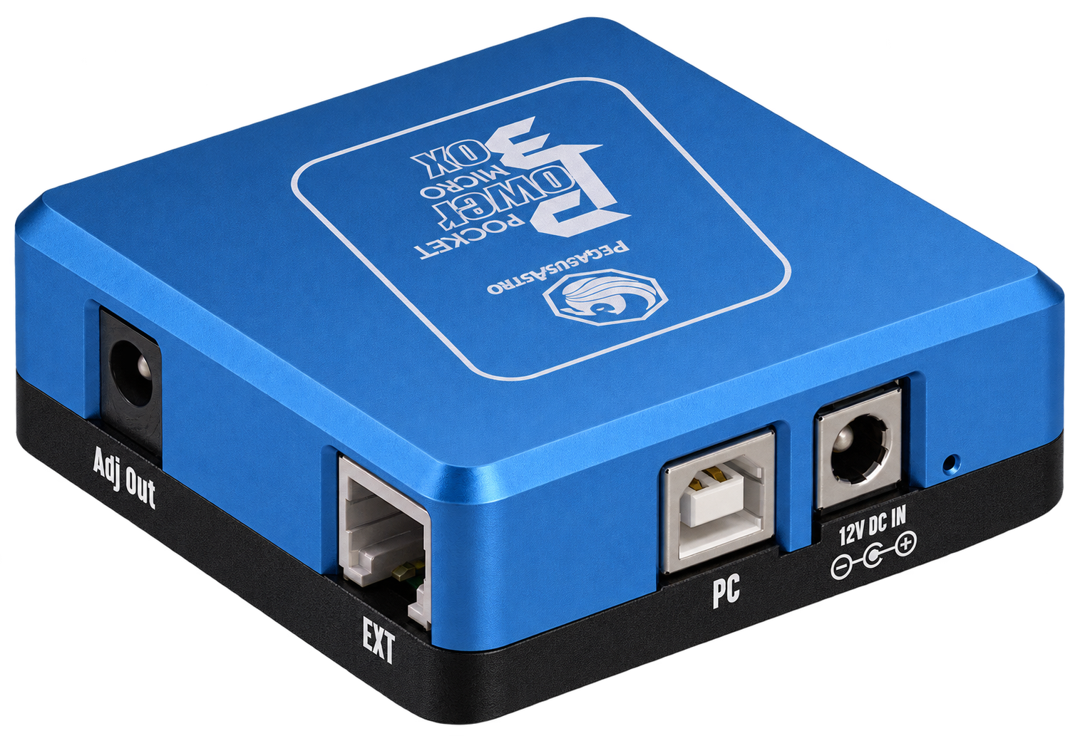

Expansion Port (EXT)
EXT (expansion) port is available for device expansion. This RJ12 socket allows the connectivity of current and future Pegasus Astro products. Plugged devices can be controlled from Pocket Powerbox Unity Platform or a dedicated ASCOM driver.
