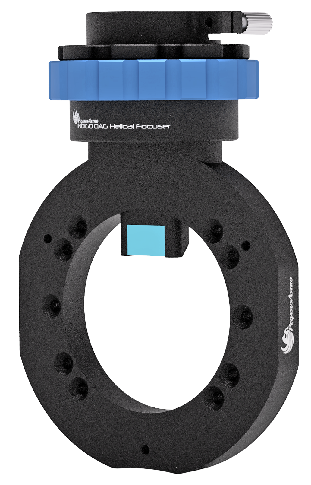

New helical focuser addon providing precise focusing capabilities and seamless compatibility with 1.25” guiding cameras commonly available in the market.
SKU : PEG-INDIGO-OAGPREM (OAG Body + Helical Focuser on top)
Please note that for customers that already own INDIGO OAG, the helical focuser can be bought separately (SKU : PEG-INDIGO-OAGHF).
PEG-INDIGO-OAGPREM

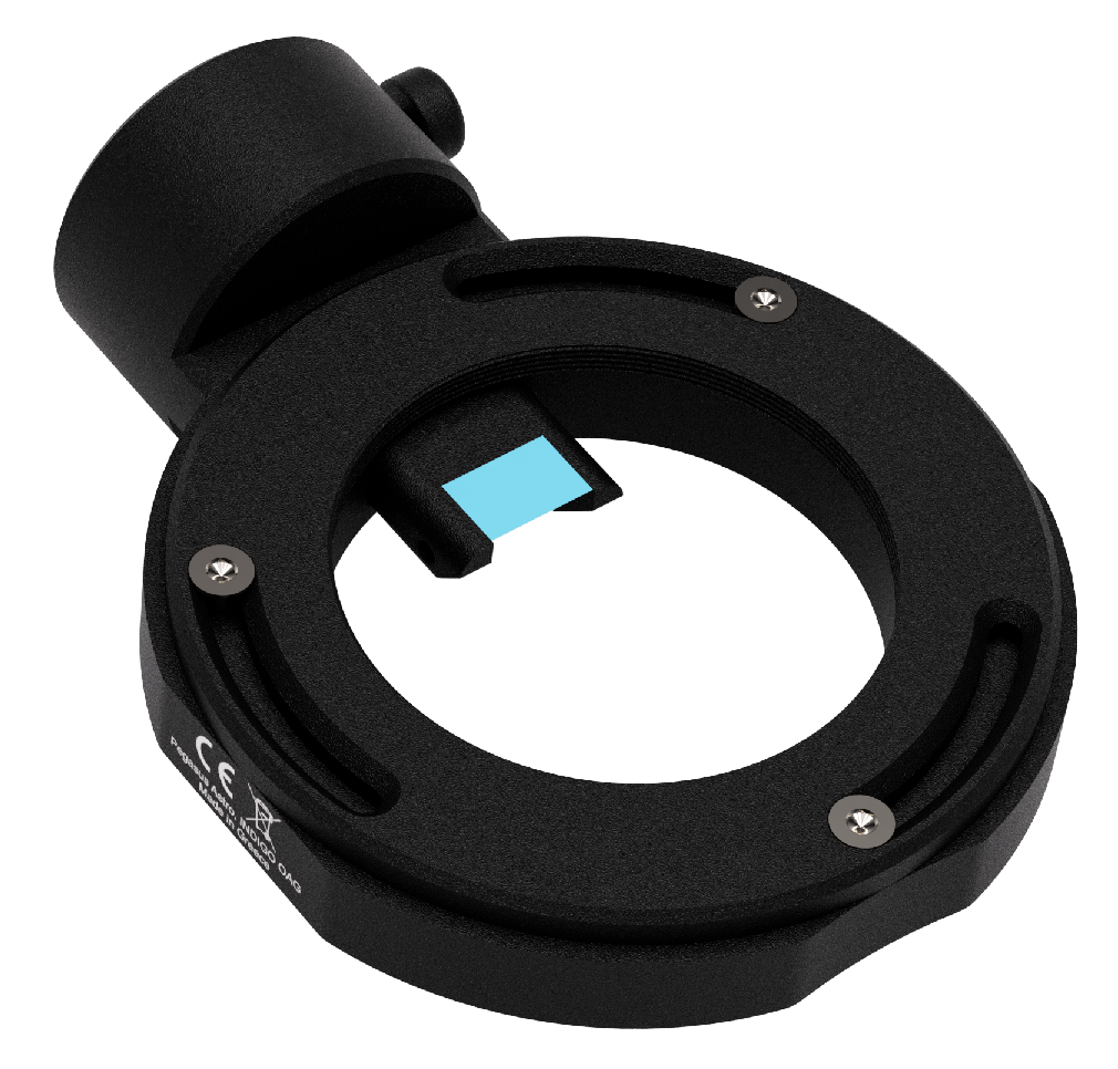

Thin Design
Indigo OAG has a very thin design. Its back focus is 10mm + 4mm of the telescope adapter. 14mm in total. OAG is CNC made of airplane 6061 aluminum alloy which ensures a lightweight and solid piece of equipment.
Adjustable prism
The prism height can be easily adjusted to allow better illumination of the field of view of the guiding camera. If your imaging camera sensor is large, the prism can be moved (and secured with set screws) upwards to disallow blockage of the sensor’s optical path.
Large mirror
A 12×8 mm fully multicoated & anti-reflection mirror offers high illumination to your guiding camera. Stars are round and bright across the OAG ‘s field.
Large Size
Indigo OAG supports the 62mm through hole pattern for direct connection with latest CMOS cameras and Filter Wheels.
Guiding camera connection is a 1.25” barrel.
Orientation of image train framing can be achieved by the 3 screws that allow telescope adapter to slide inside the slots.

Helical Focuser
The Premium package (PEG-INDIGOPREM) includes a pre-installed helical focuser, providing precise focusing capabilities and seamless compatibility with 1.25” guiding cameras commonly available in the market.
The helical focuser can also be added separately to existing Indigo OAGs by purchasing the PEG-INDIGO-OAGHF, enabling precise focusing functionality as an upgrade.
