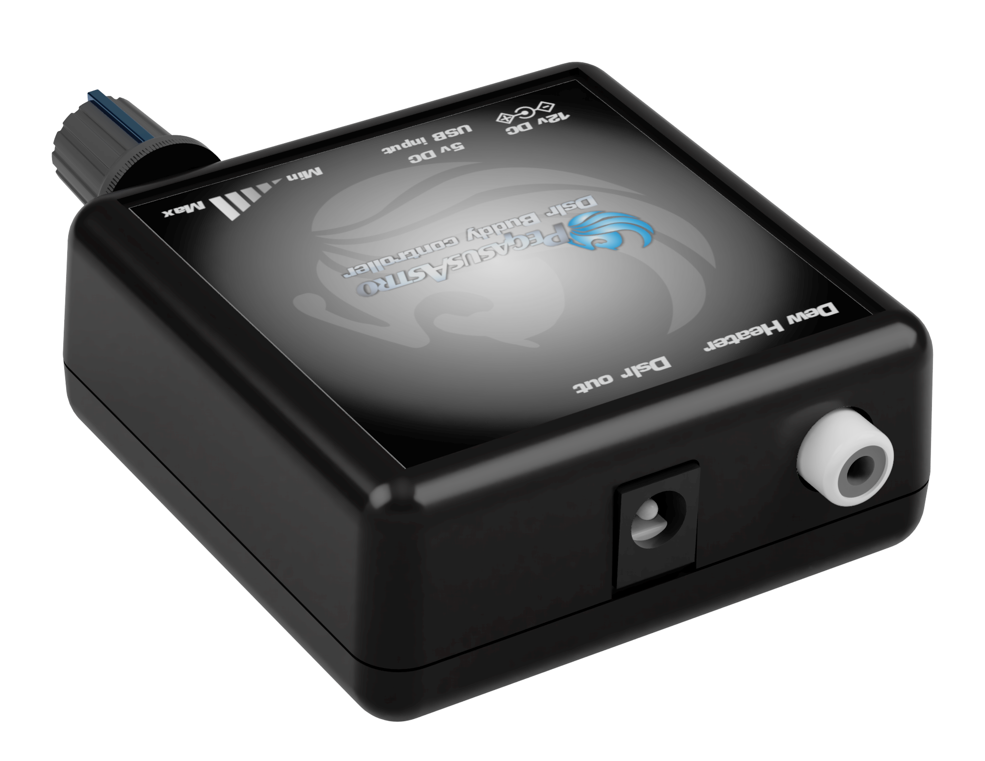

This small, lightweight device is designed for photographers with the plan to provide a constant power supply to a DSLR or mirrorless camera.
It also can power up a dew heater by varying the duty cycle of the DC voltage (PWM control). It is definitely a perfect buddy for your DSLR in the mountains and in any astro-photographic field.
With this dummy battery and the built-in Dew Heater Output, nothing can stop your camera from working for the whole night long! A unique product for time-lapses and astrophotography (deep sky, star trails, etc).

You can manually dim the Dew Heater output by using the knob at the side of the DSLR Buddy. A red light (PWM duty cycle indicator) change its brightness when you adjust the dew knob.

DSL Buddy has a built-in Pulse Width Modulation duty cycle control output for Dew Heater or Flatbox.
The device provides more than 5A of current to your dew heater strip. Get rid of the moisture on your camera lens which will definitely ruin your night!

Camera Power Output 2.1mm jack (pin is positive), DC 8V / up to 3Amps
Dew Heater or Flat Output 1 x RCA (2.5A max current)
Dimensions 66 mm x 66 mm x 28 mm
