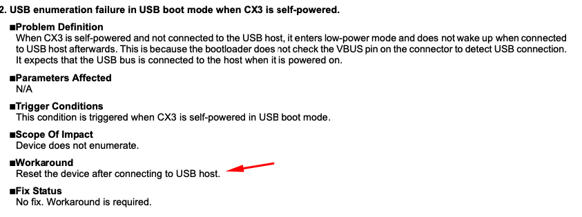

Re: Pocket Powerbox Advance - USB Port 1 does not work
ZWO has also a hardware USB bug/issue (it has to do with the USB chip/brand they use) that camera does not discovered if it has been powered before plugged the USB cable to a USB Hub
The workarround is to first plug your ZWO camera to USB and then to the 12V output.
For the record and for anyone who would like to have a better technical answer please check here why this happen. Check the datasheet of CYUSB306X ( the usb chip that most USB3 astro-cmos clones use out there)
https://www.digikey.com/htmldatasheets/ ... b306x.html
On Page 32

So the way around it is to connect the ZWO camera to USB Port 1, then connect the 12V power and then reset the powerbox as stated in the pic you attached?
