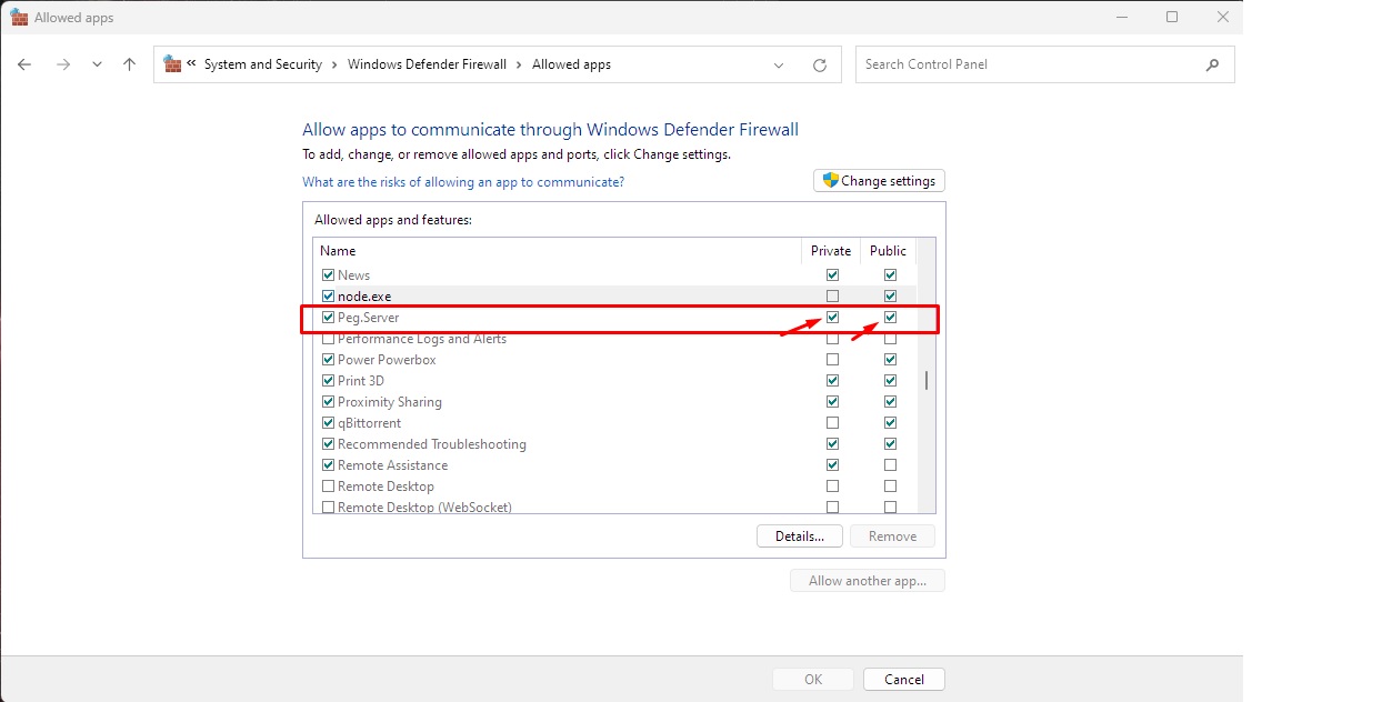

Re: Firmware update via Unity under WIN11 fails
Win10 or Win11 is not related. It works with both OS.
It might be related with your windows firewall.
Try to disable the firewall or check here:
If you fail to discover the mount via Wi-Fi, the most common reason is your firewall configuration in Windows. So, please ensure your Windows firewall does not block Unity Server (Peg.Server).
To do that please check the below screenshot and enable both options (private and public) to allow the server exchange packets with the mount's Wi-Fi.
-> If for any reason you have multiple Peg.Server records in your firewall list, it is recommended to remove all of them, open Unity, and let Windows rediscover the network connection.

Thank you for the hint about the firewall settings. I in fact had two entries one for private and one for public networks.
The reason for the two might be that I first setup everything at home and later I took the setup for holidays and the
hotel network was then setup as public. I removed the two and created a single entry as displayed in your post.
Once a new NYX101 firmware update arrives I will report if this solved the problem on my WIN11 machine.

I finally can report success.
After changing the firewall settings from two two one entry the update procedure runs without any problems.
Thank you Evans

I also just had success with the latest mount firmware update using my Windows 11 Laptop, after cleaning up the windows firewall as suggested by Evans.
Thanks for the help.
