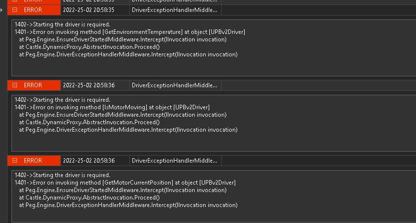

I am using the new Pegasus Astro Unity with a FocusCube 2 and a Ultimate Powerbox2 and a Motor Focus Kit Universal connected to the Ultimate Powerbox2.
Using Unity software I connect the Powerbox2 and the Motor Focus Kit without issue but can't connect the FocusCube 2.
I get an error message (see attachment).
In the main screen of the software, I can see both hardware.....
Using the FocusCube software, I have no issue, evrything is ok.
Thanks for any advice.
Regards

Please check any ERROR logs under Configuration -> Logs -> Server (tab)
You can click refresh button and check the ERROR (in red) logs at the end of the file

You will find part of "log" with some ERROR message.
Hope this help.
Regards
Eric
Re: Issue with Pegasus Astro Unity
You can expand each error message pressing the + symbol on the left.
We need to read the message of each error line.

Here is the details.
Let me know if it's ok ; I could do more test........
Thanks

Hi Eric,
Thanks for the screenshots.
We found the bug and we'll provide a fix by tomorrow.

I tried the new Unity software this evening but still can't connect the FocusCube2....
Here is the log with ERROR....
Thanks in advance
Eric

Hi Eric,
It is better to schedule an anydesk session so we can have a look of what is going on.
Please reach us at support@pegasusastro.com
