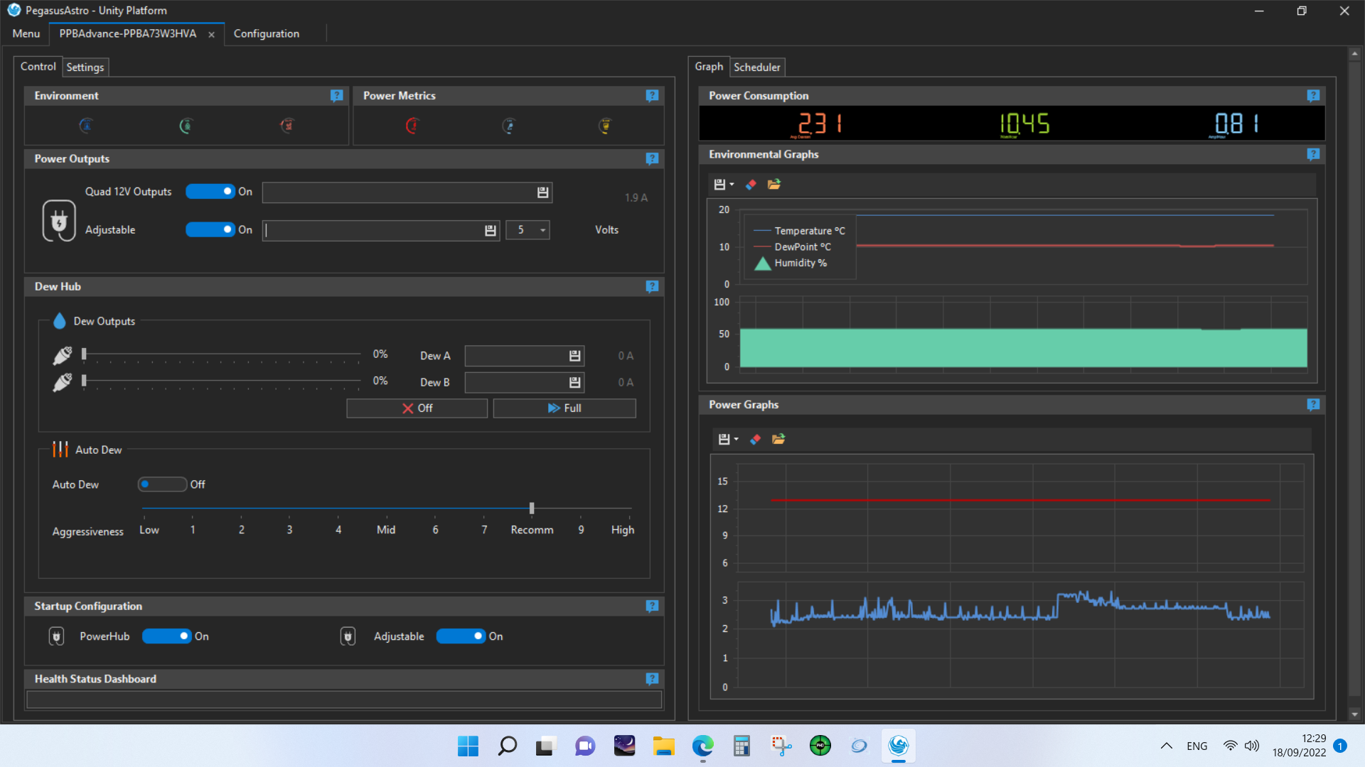

On my advanced Power box gen 2 recently purchased, the Adjustable Power output does start at startup. I have checked the box in the StartupConfiguration menu which stays checked after repower but it is the Adjustable in the PowerOutputs menue which turns off and does not go on ON after repower. It is supposed to power my WIFI router for me to connect to a mini pc on my setup.
My configuration is:
- Mini PC Mele Quieter3
- Windows 11 pro (up to date)
- Your unity platform with the latest version (downloaded yesterday)
- The Vonets WIFI device is powered on 5 Volts
I am obliged to connect with a cable then openup unity and turn on the Ajsutable to power the router ...
Do you have a solution for that ?

My problem is solved ! I de-installed and re-installed yesterday evening and now it works.
Is there a PPBADV.ini file somewhere which could be accessed to force some settings ? In case the problem reappears …
