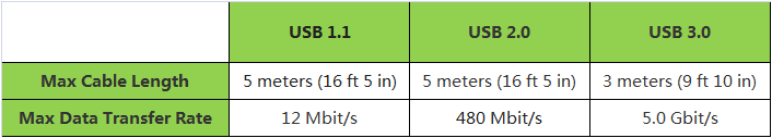

Re: Usb extension cable
USB3 protocol does not guarantee reliable transmision for cable more than 3meters.
For more information please check here: https://pegasusastro.com/cable-manageme ... phy-setup/
usb_length (1).png (12.28 KiB) Viewed 34673 times

Thanks for the guidance. Will reroute cables and separate the power and usb cables to see if it makes a difference.
