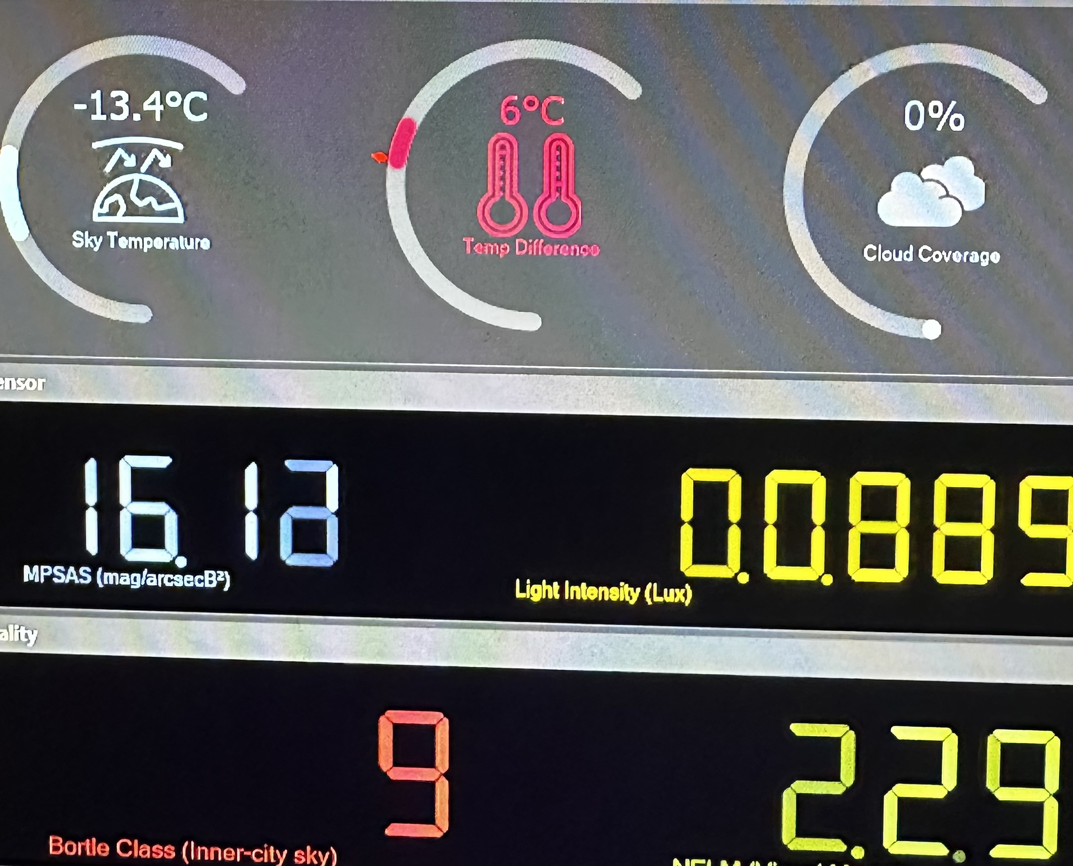

I seem to be having the same issue, looks like it’s a software issue as the sky temp sensors are very accurate and can detect small temperature differences on the graphs but the cloud % doesn’t change, even holding it indoors sometimes it says like 60% cloud cover. I have the same set of pictures showing 0 clouds with overcast skys.

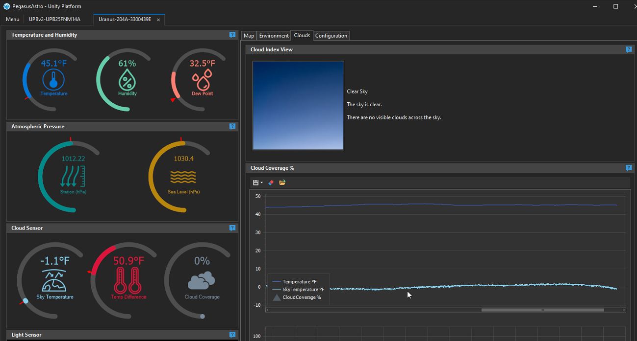

Please upgrade to the latest Unity. There is a settings tab at Uranus dashboard that allows you to tune /offset each sensor including cloud sensor

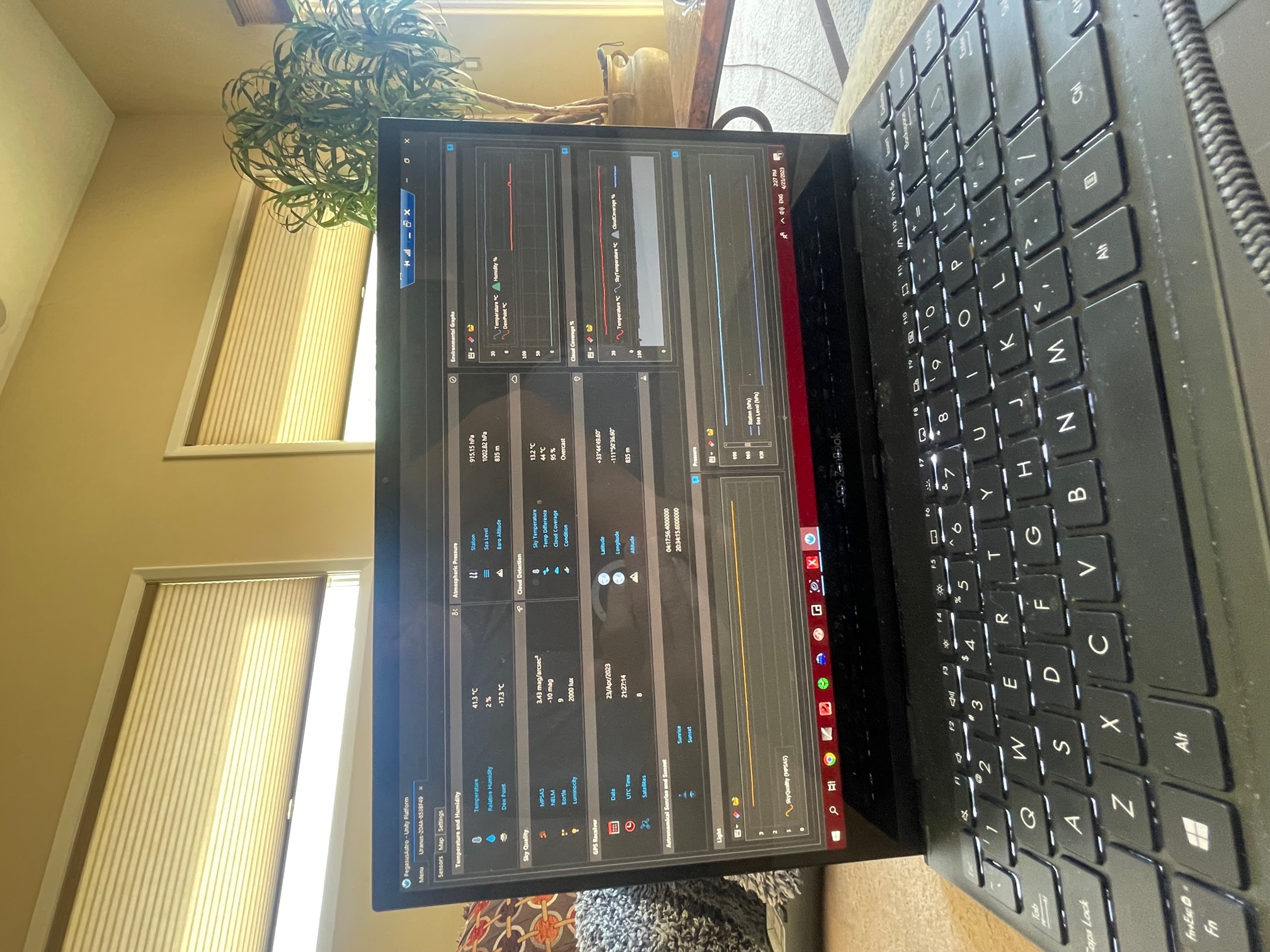

[attachmenJust couple points
I have never had the actual battery in case. I power thru Eagle 4 to Uranus via USB connection. I always have to replug USB TO Uranus to get Eagle to recognize the unit
I have load the latest version of unity software. Even when I reduce cloud sensor to -65. Cloud coverage only drops from 100 percent cloud coverage to 94 percent. I did this test during day when there is little to no clouds. I have also debooted and via software and also by pushing button on hole left on unit.
Below are photos of sensors ect.
Last will you be possible bringing back large icons as current format even under large format is difficult to read.
