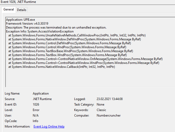

Just received another error pop-up at 1.7GB memory consumption.
When you confirm it with "OK" it keeps opening up again and again. And then UPB crashed with an .net exception but unfortunately when clicking on details the message disappears. It was closed with the application. But Eventlog shows the same error as before. See third screenshot.

One more error:
Re: UPBv2: Software crashes due to memeory leak
The latest version is absolutely unstable. It crashes frequently. A serious usage is not possible.
Yet another:
Yet another:
