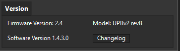

hi, my UPBv2 application recently invited me to update my UPBv2 software and firmware. which i did,
2021-02-10 09_43_30-Ultimate Powerbox.png (2.95 KiB) Viewed 14779 times

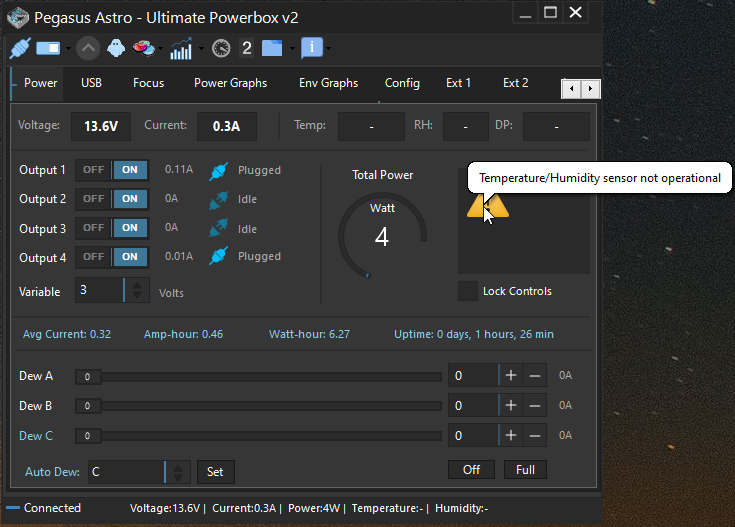

I am not sure if the 2 events are linked but i now have this warning/error message suggesting the environmental sensor is not working.
and to be honest I cannot see any evidence that it is working
2021-02-10 09_49_32-Ultimate Powerbox.png (135.59 KiB) Viewed 14779 times
2021-02-10 09_54_55-Ultimate Powerbox.png (18.79 KiB) Viewed 14779 times
I also have many red lines in the Log stating sensor is non-operational
has anyone else had this problem or seen this and if there is a definite way i can check if the sensor and UPBv2 are working correctly or are talking to each other.
I am not sure if there is a way of reversing this software update to check .
any thoughts would be appreciated
regards .. GSP
Re: UPBV2 environmental sensor issue
It is unrelated to the firmware update
Most probably the sensor cable is damaged. ( a wire is cut inside)

you are indeed correct, the green wire had broken free.
I unclipped the cover , removed the white RTV and re-soldered.
I took the tie wrap off ( to be honest this has no practical value in saving the joints )
once i validated my joints I entombed all the joints and rear cavity in liquid plastic.
thanks again for the pointer
GSP
