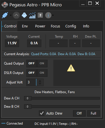

I just received my PowerBox Mini and I am curious about the output values.
My PowerBox Mini was set to 3 volts. Does this mean that a maximum of 3 volts will be delivered on each of the four 12 volt output ports?
Does the PowerBox automatically adjust upward the voltage for a port if the needed voltage is higher than the Adjust Volt value in the app?
I am guessing that that Adjust Volt setting in the app is for all 4 ports?

The ADJ volt setting is only for the ADjustable output (which is a different output from the 4x12V)
Quad outputs provide 12V without any change.

Thank you for the clarification.
