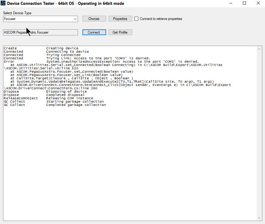

I am getting exactly the same error, with the same DMFC, and Win 10 v20H2. It is happening on 4 different PC's . I can connect and run the focuser standalone, but when I try to connect to the ASCOM diagnostic, as NINA gives dot net error message and will not connect, I get an "access to port com 3 is denied, etc, etc. ASCOM 6.5SP1, Focus cont 4.5.5, CDM1228
Pegasus ASCOM diagnostic.jpg (61.77 KiB) Viewed 33274 times

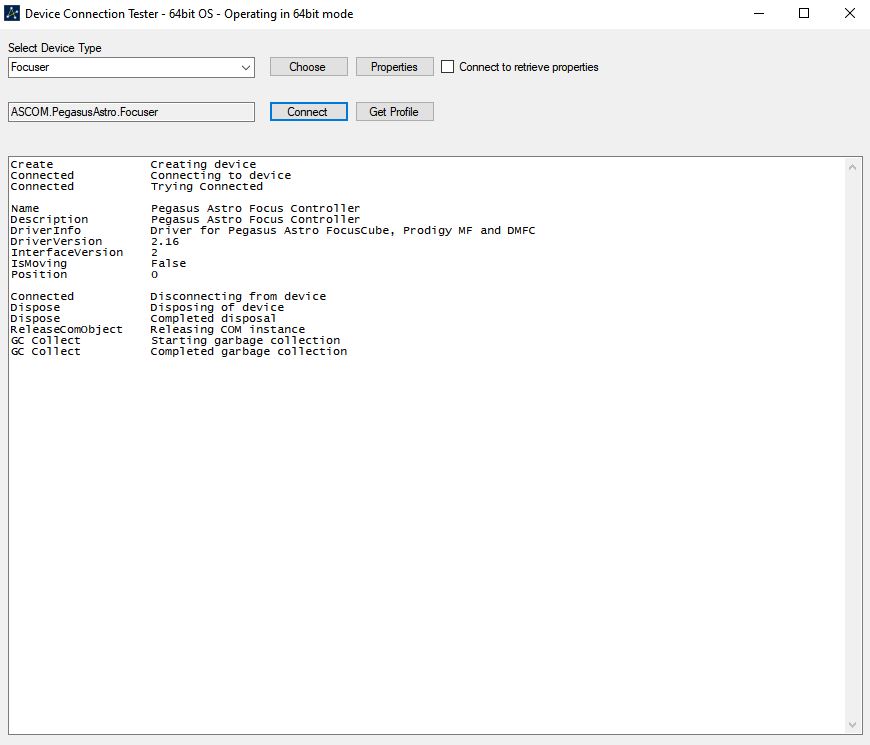

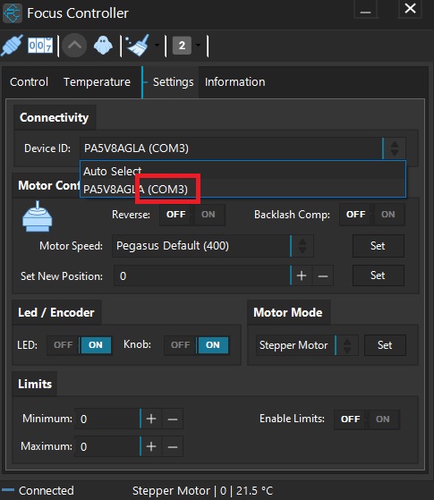

thanks for the reply. I immediately tried, what happens on my computer when I run the Device Connection Tester. That strangely works.
To help you, I also can reproduce your screenshot, when I have the Focus Controller running and connected at the same time. So please try to close it or perhaps verify, if COM3 is correct. For example here:
Focus Controller.jpg (69.46 KiB) Viewed 33270 times

Thank you for your prompt reply. I then started looking at my Ascom Diagnostic again and discovered that if I ran it without running the Pegasus software first, it gave the same good response as your pic! I then tried Nina without running the Pegasus app and Voila! everything worked.
So it turned out that if I had not used the Pegasus app, all would have been well.
