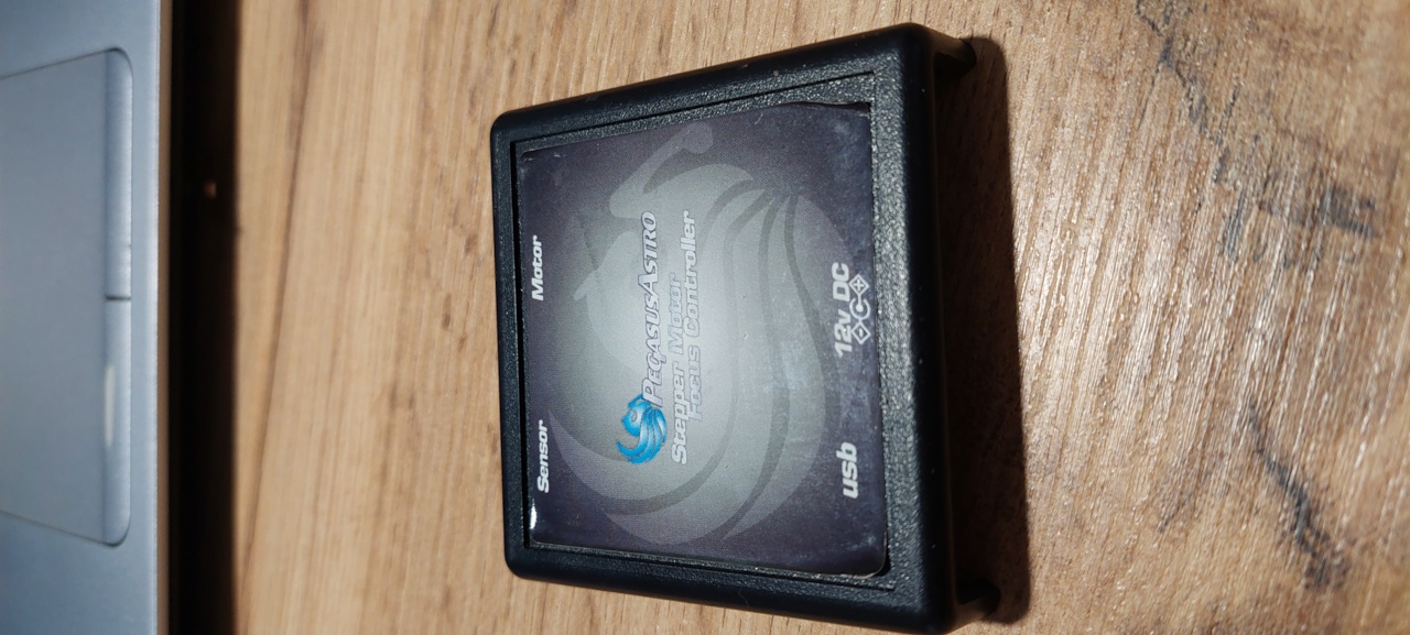

Hello, what kind of controller is the below one?
Where can I find an Ascom driver for it?
Regards
Lakio
