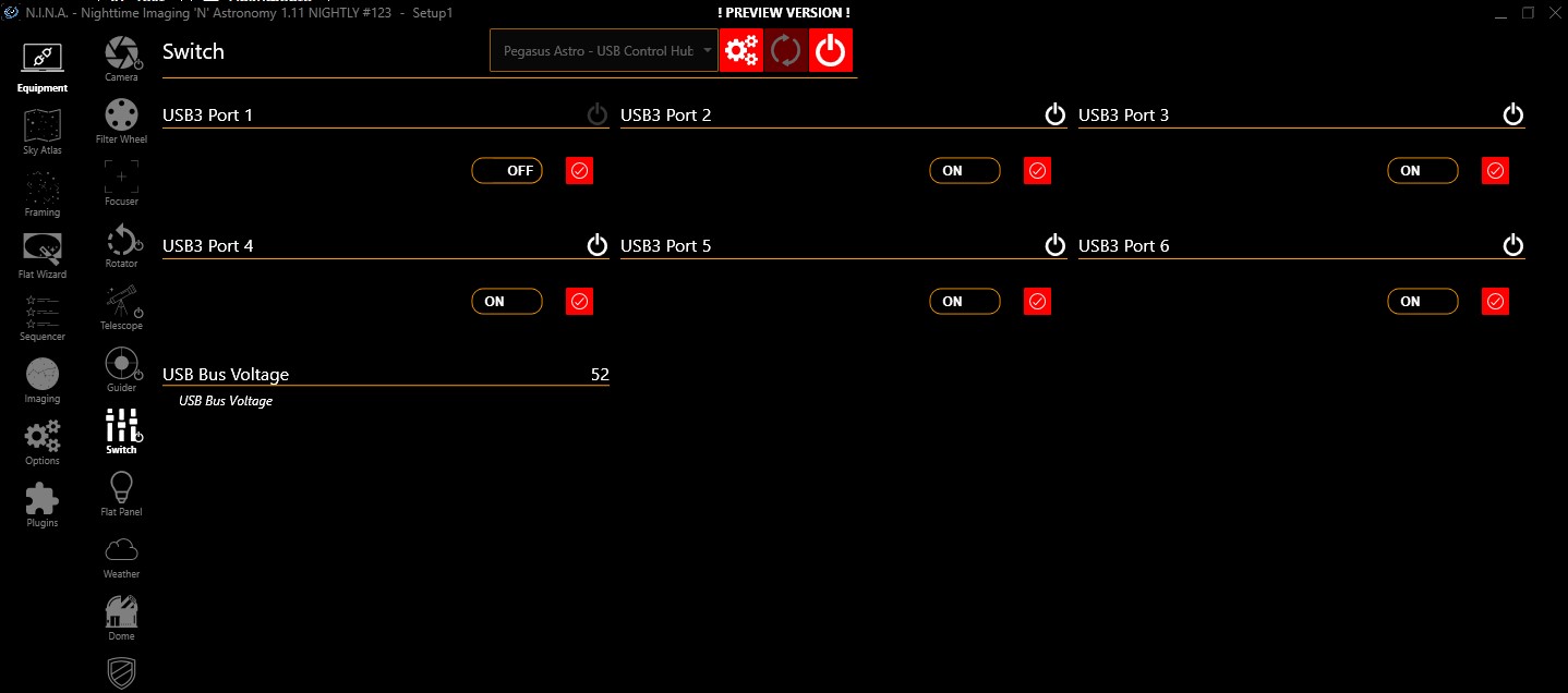

Pegasus Astro – USB Control Hub (in short UCH) Switch 1 always off / and port named can not written by own
Steps to Reproduce
Connect Pegasus Astro – USB Hub
Set all Port`s ON (and set new value)
Disconnect the Hub
USB3 Port 1 is OFF
Set USB3 Port 1 ON (and set new value)
Disconnect the session
Start new session
Connect Pegasus Astro -USB Hub
USB3 Port 1 is OFF
And so on…
Expected behaviour
the setting should remain.
------ further: it would be very good if the individual ports could be named individually-----
Actual behaviour
Port 1 it is always set to off by restart
-----the port`s named is fix------

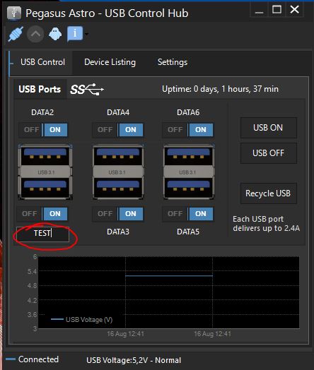

The power-on or connect port state is managed by the Pegasus ASCOM driver and/or its management app (if it’s like other Pegasus products, which do have one). When NINA connects, it just reads the state of the port; it does not set them to any previous state. The naming of the ports is also controlled through the Pegasus UCH management application. Generally, you double-click the name in the app and type in the name you wish it to be. NINA would never be able to change the name of the switch directly as the ASCOM Switch specification marks the switch Name as read-only, anyway.
In short, everything you want to do is, or should be, configurable through the Pegasus UCH management app and is not of NINA’s concern.

Michael REPORTER
Hi Dale,
Thank you! I understand your explanation! but…
I've tried again now.
I try to explain it.
when I start the Pegasus app (1.4.2.0) I can set the switches to On. Then close the app and start it again, the switches are in the last state.
But.
When I start nina the first port (USB3 Port1) is immediately OFF.
I close nina and start the Pegasus app the switch is OFF again.
Another example
I can set the remaining five ports or switches as desired, whether off or on.
Confirm this with the check mark -set new value-.
and it is saved, it is the same with every start.
even when the pegasus app is started, the values are changed as set in nina
only the USB3 port 1 does not work
about the other thing:
In the pegasus app the ports are called differently than in NINA
and the ports can be renamed in the app but that's doesn't change the names in nina
therefore the question
whether it would simply be possible to use an input field to assign alternative names in N.I.N.A. it would be much clearer that way.
Hope I don't upset anyone, but I'm happy to share my opinion anyway.
Thank you !
And i like NINA more than any other thing!
BR
Michael
