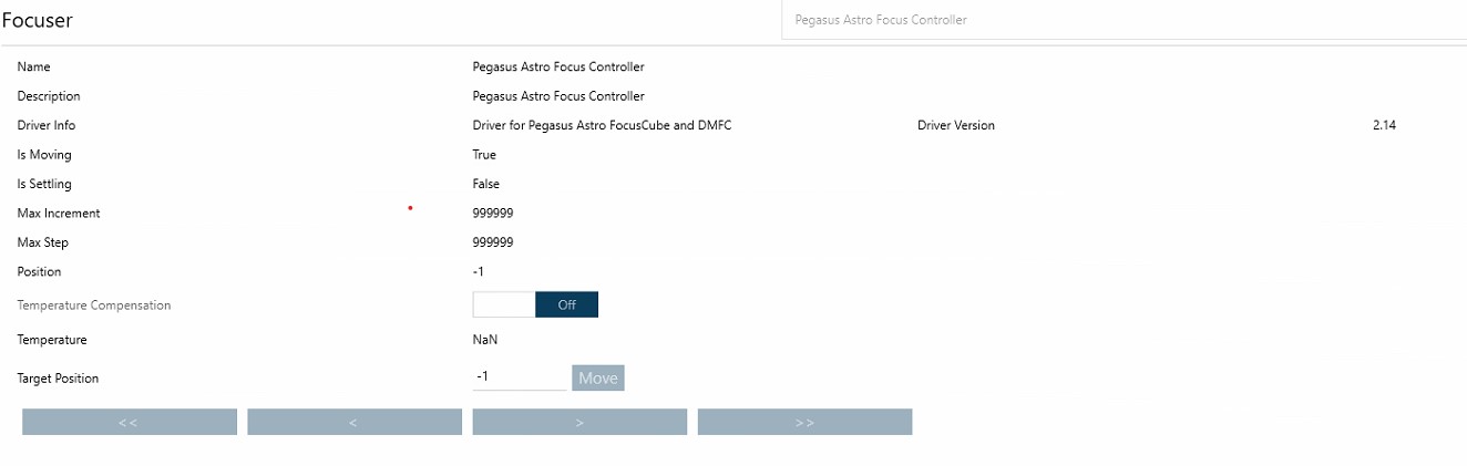

I earlier reported about issues with Stellarmate and SMFC. Now I have that working thanks to Jasem from Stellarmate. I switched to PC in my main rig however, due to the new camera. Now, with Nina, I cannot get SFMC working. Data that it shows is weird as in the attached picture;
IsMoving True
IsSettling False
Max increment 999999
Max Step 999999
Target Position -1
And move buttons gray.
I am wondering is this the same issue?

- Annotation 2021-06-01 234614.jpg (35.89 KiB) Viewed 26869 times

ASCOM does not accept negative values in position. If you move a positive value it will work.

According to Pegasus software, position is 35230, and the focuser is almost fully open. I think that negative value is a symptom of the issue rather than solution?
Edit: Tested it by moving the controller through Pegasus Focus Controller. Position now 35245, and movements to different directions lead to no changes in the Nina figures. In Nina, position remains at -1, I can insert target position, but cannot press Move button, or any of the arrow buttons at the bottom.
