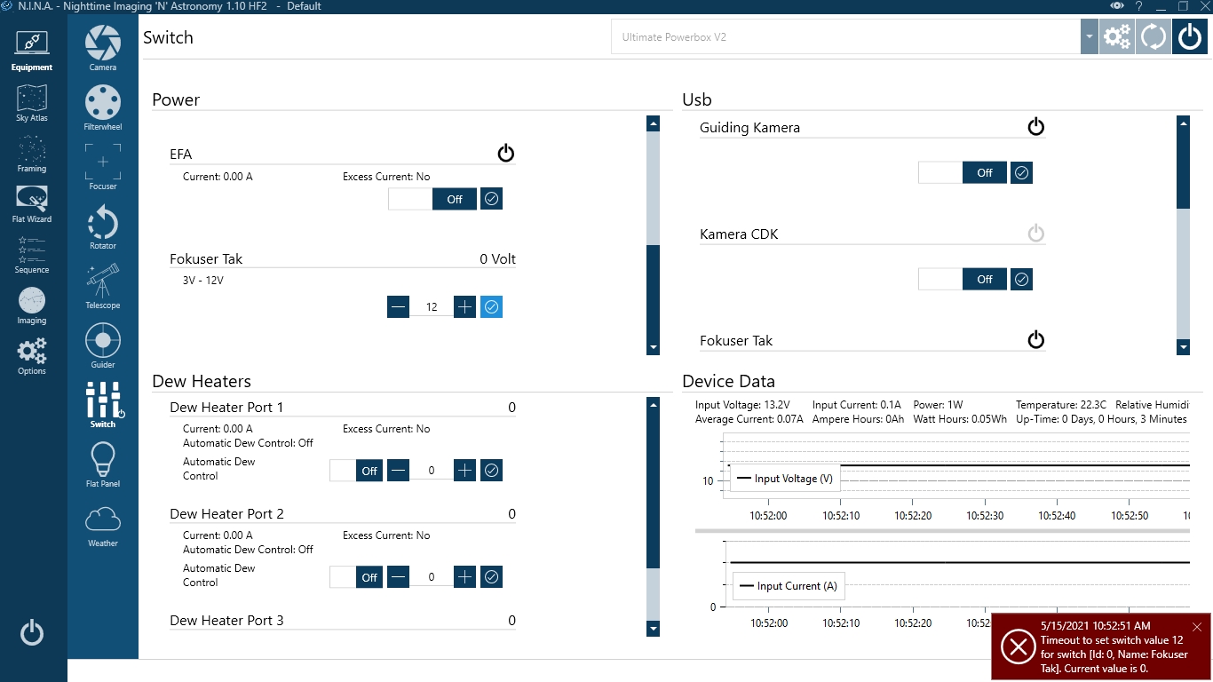

I have run across an issue when controlling the UPBv2 from within NINA.
I cannot use the variable output (3V-12V), when I try to set it to 12V it gives me an error message (see screenshot, labelled "Fokuser Tak").
There seems to be a timeout.
It works without issues in the Pegasus Windows application.
Could this be related to the fact that in the Pegasus Windows application there is a pop up window where one needs to confirm the value change?
There is no popup window in NINA.
Did I forget to configure something correctly, or is there a bug somewhere?
Thanks.
