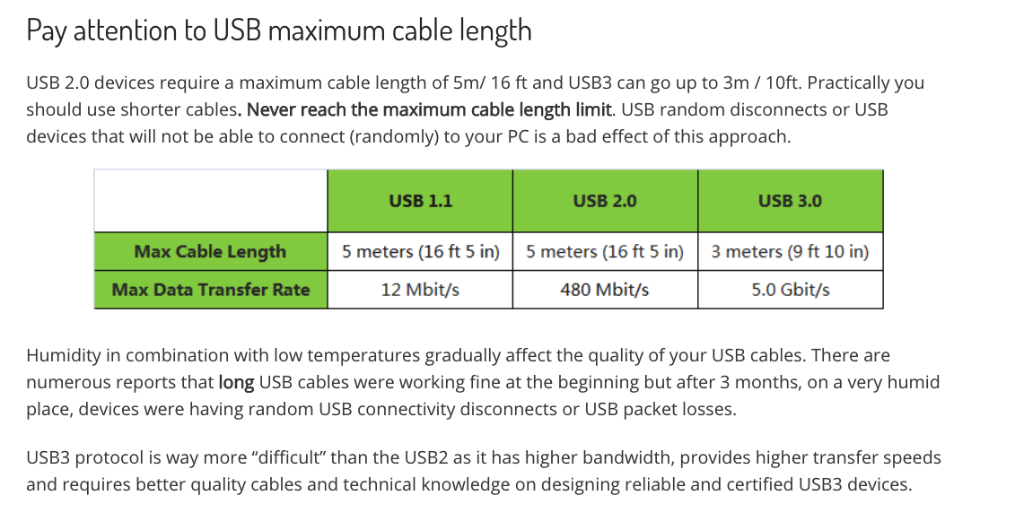

USB3 protocol has a max cable limit of 3meters.
Some devices have a transciever that might work at longer cables but as you exceed the 3meter limit there is no guarantee that it will wok stable and flawlesly.
For more information please check here: https://pegasusastro.com/cable-manageme ... phy-setup/
Screenshot at Apr 18 13-18-00.png (153.71 KiB) Viewed 22932 times

I have seen that table already on the PegasusAstro cable management page...https://pegasusastro.com/cable-manageme ... phy-setup/... The sections following the table discuss cable extenders and powered hubs for USB3. While not explicitly stated, does the use of a powered USB hub NOT change the USB3 maximum of 3m? In an observatory situation, this is a severe limit.
This does not make sense, because my setup does work with a 1m USB3 from camera to powered hub, followed by a 5m cable. What makes it fail is the addition of the UCH and an additional 1m cable from the UCH to the hub.
