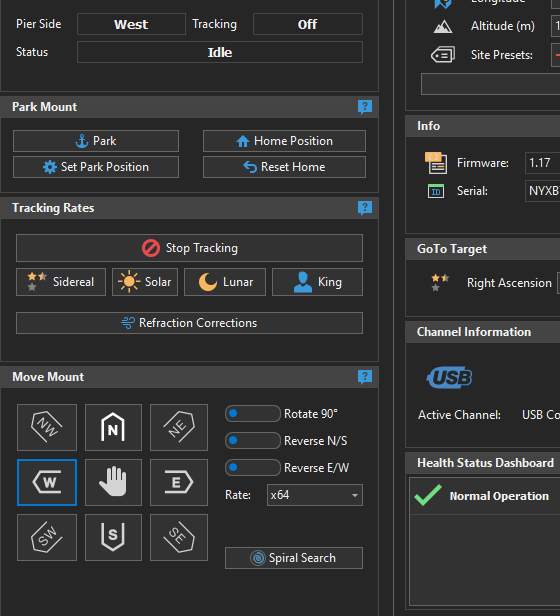

Updated list of steps.
I suggest you connect the mount power and USB to a PC, then turn on.
Launch Unity on the PC and select the mount at startup.
Check things make sense roughly.
See the image below - This is what mine looks like at this point:
Click the Home button. The mount should lift the brake, whine a little and may move (if not at Home already).
Then increase the slew speed to x64 and press the arrow keys and see the mount moves.
(The brake must be lifted for the mount to move, and it is, OK)
Get a good bit away from Home, then press the Home button and you should get a good, smooth set of movements.
Hope that helps.
cheers
Tim
