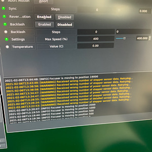

This is another error I get during a session with the UPB in INdI too....doesn’t seem an issue but wondering what the issue is at it happens all the time...

As asked already what are these errors, maybe I get a response this time....
