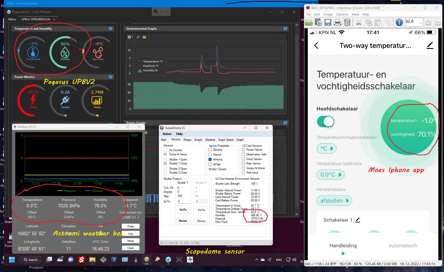

I opened up the sensors that I mentioned above.
Despite what is written on them, they are NOT identical to the chip used on the UPB V2
Thank you once more Evans for warning.
Still the issue remains that it appears to be not easy to do a reliable measurement of the humidity.
The analogue (calibrated) hygrometer (not pictured here) showed 63%
The white display on the right is the app from the gimmick I showed above.
Its sensor was 10cm away from the UPB V2 sensor.
The Astromi MGP weather box is a device used by 10Micron users.
The Scopedome also has its own sensor box mounted higher up in the dome
The UPB V2 doesn't indicate 99%, but still is remarkably higher than the other indications.
Coming back to the topic starters' request: which value to believe to be accurate?
