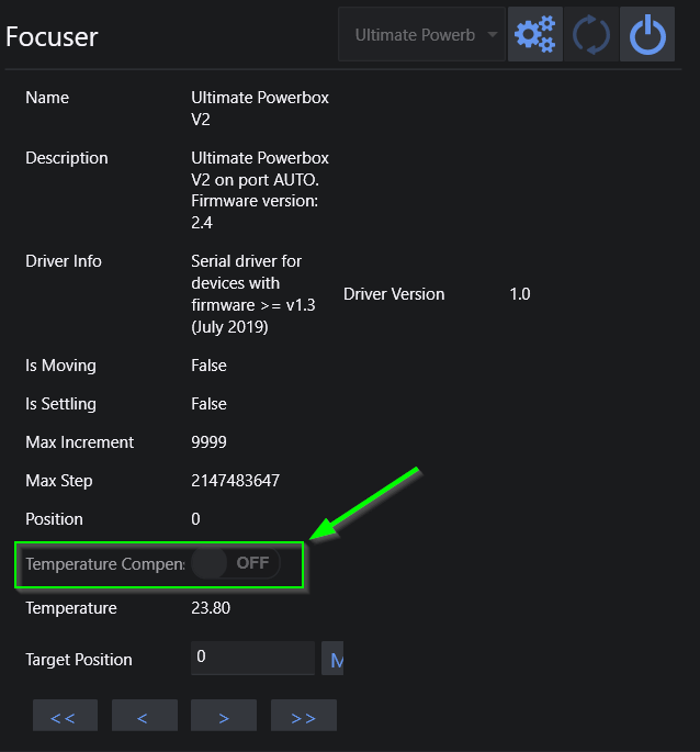

hi, this is not an answer to the previous comment but just a wish for a similar understanding with the Pegasus Electronic focuser Universal Kit (running through a Pegasus UPBv2). I use NINA for my sequencing application and have the Electronic Focuser hooked in NINA but the temp compensation is inactive even though i have an Environmental Sensor attached to the UPBv2.
? - would i be right to think the Pegasus Electronic focuser kit does not have the capability to Temp compensate.

Re: FocusCube temperature compensation
Unfortunatelly temp compensation is not supported in ASCOM driver.
As most people use the V-curve model the temp compensation way is a little bit "old aged" way to focus. It definitely does not ensure that your focus point will be accurate.
Although, we have it on the list to support in in ASCOM driver soon.
By the way this screenshot is for the Ultimate Powerbox v2 and not for the FocusCube.
FocusCube supports in standalone software the temp compensation functionality
