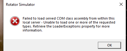

I do have Unity running, it can see the UPBV2, the filter wheel is shown and will work when commanded within unity for filter changes. when connected via UPBv2 and direct to the PC.
NINA will connect to my Pegasus focuser, and all other equipment but not the filter wheel.
The filter wheel selection box shows "PegasusAstro Indigo" , if I click on the gears I get an error message box popping up in the background and NINA freezes and needs a restart.
The message states rotator but it is the filterwheel that sends that message out,
There are no other Pegasus options in the drop down menu.
So frustrating !!
Indigo error.png (13.19 KiB) Viewed 20589 times
