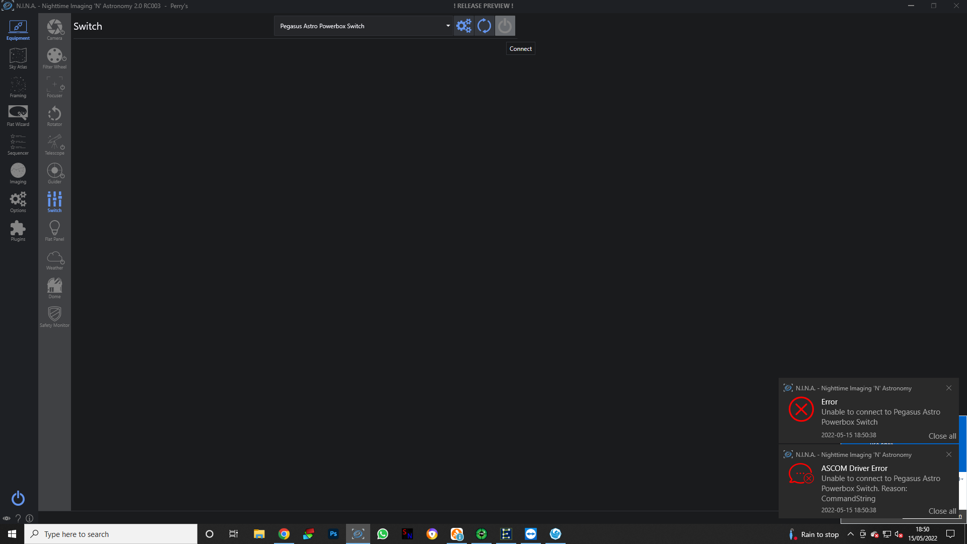

Hi I’m trying to connect my new ppb advance to the ascom switch in Nina but it won’t connect and I get the message in the bottom right of the attached image. I have the unity software open. Can anyone help please.

Are you using an old Ascom driver?
If you have a Pocket Powerbox Advance you should be able to select a different device. Try it with „PegasusAstro PPBAdvance“. That works for me.
However, when doing so, the possibilities in N.I.N.A. are somewhat limited. See attachment.

Re: NINA Ascom switch
Try to click the gear first and select your device.
Then click connect and it should work.
