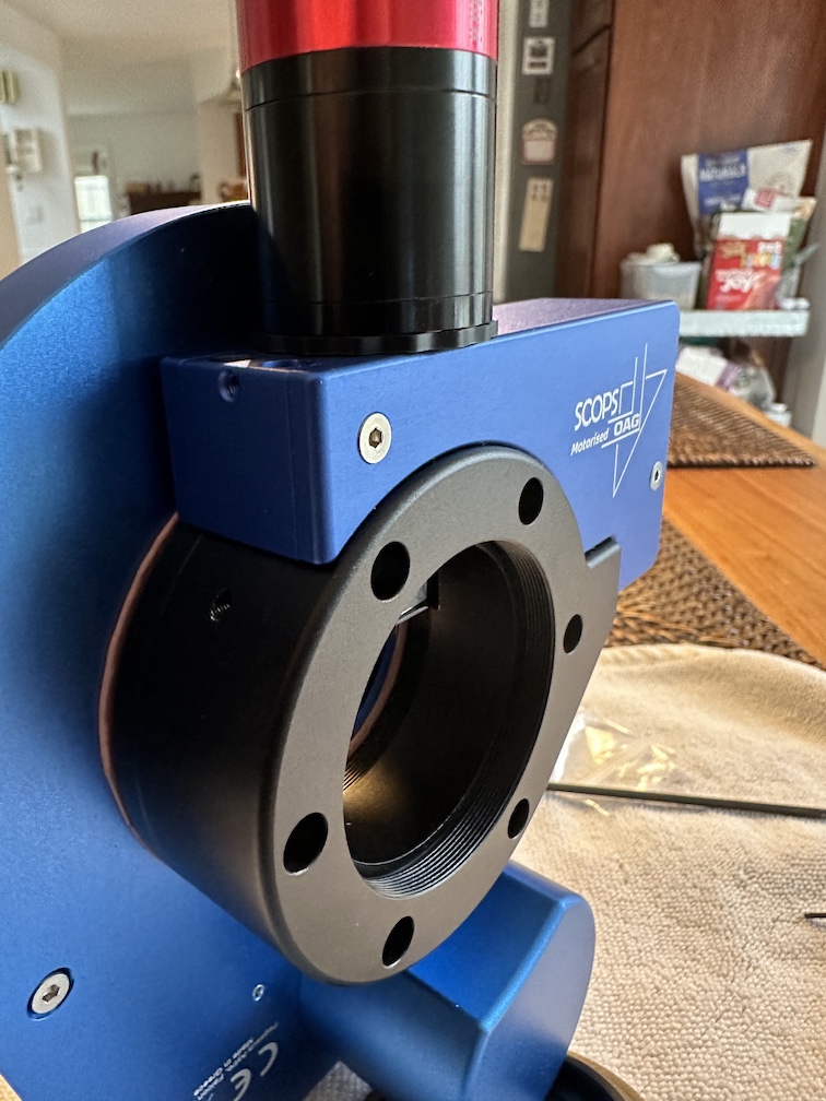

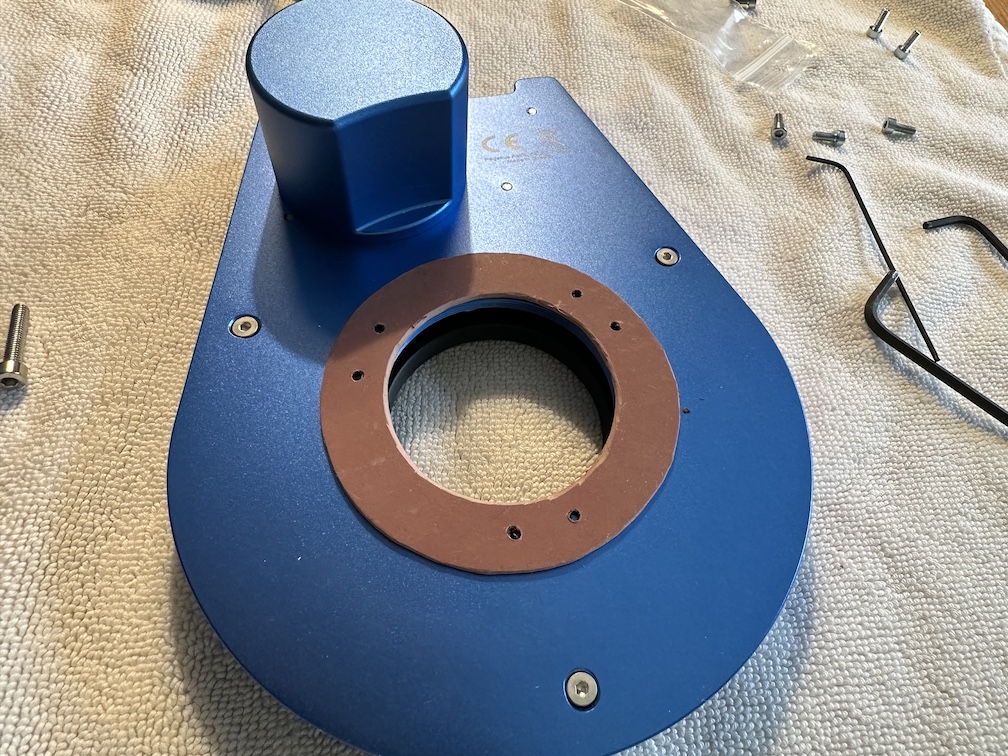

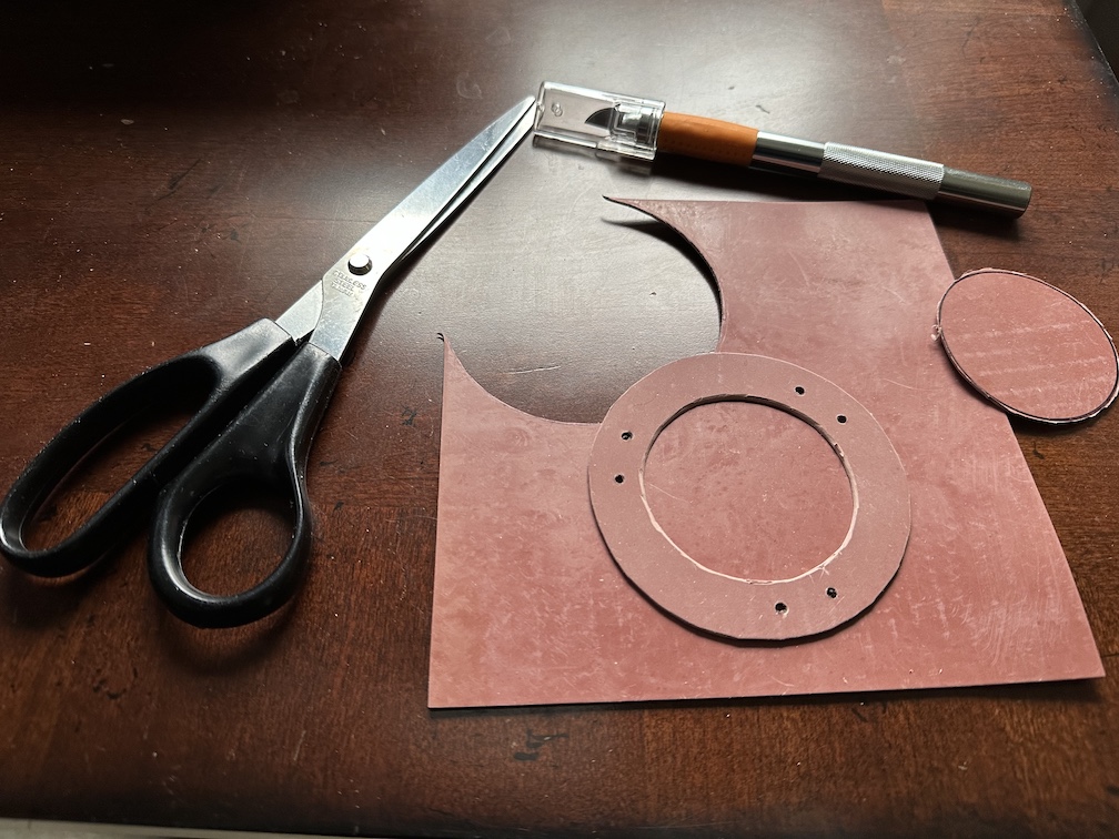

Searching for this (having just bought the Falcon Rotator and the Scops OAG and encountering this issue) I landed here. My solution was to add a spacer beneath the ring that mounts to the Rotator that I made out of a sheet of gasket rubber similar to https://www.amazon.com/Generic-Silicone ... B096MYWM4X that I had lying around. This adds about 1.4mm of backfocus, but who's counting. This provides just enough space to add the small camera tightener nut provided in the kit. I also put some Teflon tape on the threads just 'cause it is so loosely coupled.
Pictures below.
Cutting spacer from gasket sheet
Attaching gasket to Falcon Rotator
Closeup of final result
