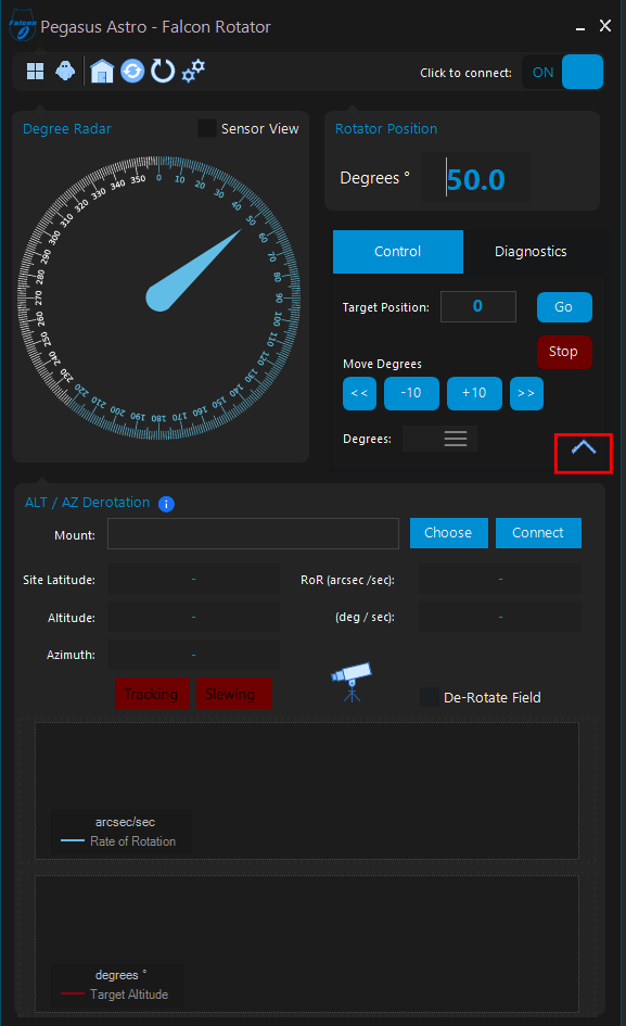

Is the field derotation support for alt-az still work in progress? Or, is it now supported? I don't see anything about it in the stand-alone control software. If it's not there, how am I supposed to turn on the field derotation ?
Thank you
Re: derotation support for alt-az mount
You have to click the arrow at the bottom right to expand the window for the derotation calculation functionality
