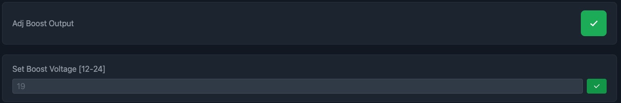

I am unable to power a NUC from the 12-24v port on my upbv3. I've tried two different nucs, neither one worked. I'm using an ordinary 55 x 25 male to male cable to connect.
What am I doing wrong? I have set that port to 19v, and the UI seems to verify that.
upbv3 19v .jpg (28.46 KiB) Viewed 13331 times

Probably the PSU you use is low in current.

You don't need to - The NUCs work down to 12 volts - I have had 5 NUCs over the years and they all work off my observatory power supply, which I set to 13.5V, which allows for voltage drops and guarantees minimum 12 volts. This has been with UPBV2s and 3s.
Just use the always on power output. You will need a short power cable with two slightly different plugs. The NUC socket has a fatter central pin.
