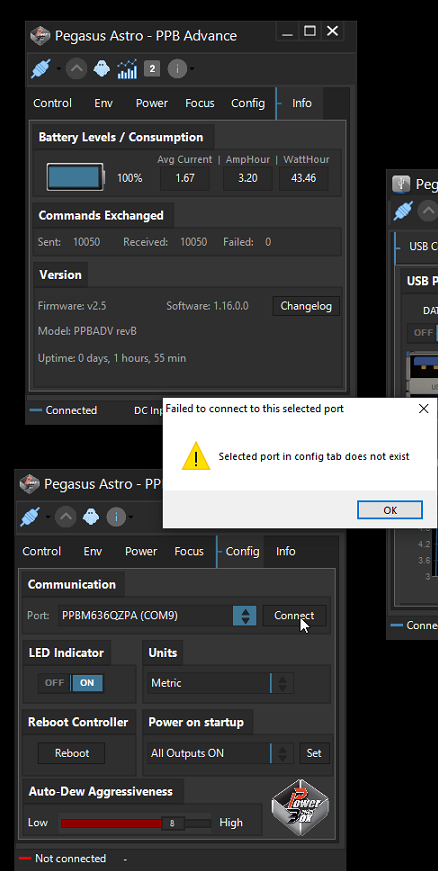

I have both a PPB Micro and a PPB Advance. When I start up PPB software (Ver 1.16), it connects to the PPBA and functions normally. However, I cannot start and connect to the PPBM. If I try to connect via a 2nd instance, it sees the PPBM and even assigns a COM port, but when trying to connect, it cannot find the COM port!
Any suggestions. Any other info that would be helpful?

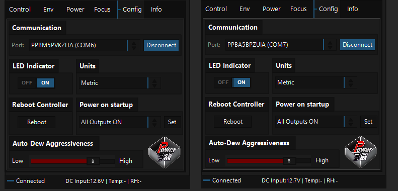

Can you check the port on each instance.
I tried to replicate your issue with no success
Below image shows a Micro and an Advance in parallel
Screenshot at Apr 03 14-39-28.png (43.33 KiB) Viewed 17753 times

Using USBVIEW, I was able to determine that, even though the Pegasus software decided that COM9 was the appropriate port, the actual connected port was COM13. I changed from 9 to 13 in Device Manager and both instances connect now.
This begs the question, however, of why the Pegasus software identified an incorrect port.
