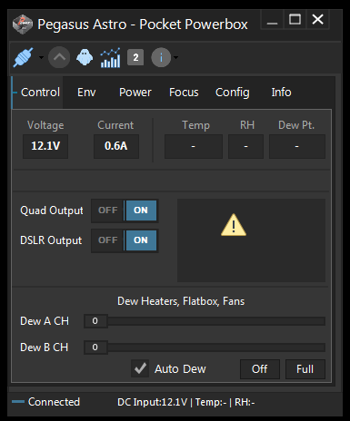

I notice that when the powerbox micro is powered (and connected to USB) constantly draws (or reports that it draws) 600mA. Even without anything connected to the DC outputs, without the temp/humidity sensor plugged in and with all 12V switched off and dew controls switched off: 600mA
Is this a real current draw of the idle controller onboard? That's a pretty big load to have running on a battery all night
edit* 600mA at ~12.4 volts (so 7.2 Watts continuous draw).

Idle current draw is less than 0.06Amps.
Can you please send me a photo of what you see?
Either the current meter is off and requires recalibration or something leaks (well.. consumes) power.

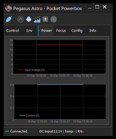

Here are the screenshots:
BTW: I'm also the one who posted about the inability to adjust the adjustable DC output (since the sw does not detect the unit model): could this be related?
- pbmicro_600mA_1.PNG (15.19 KiB) Viewed 18277 times
- pbmicro_600mA_2.PNG (17.98 KiB) Viewed 18277 times
Re: Power consumption of PB Micro
Indeed, it is related as it reads and converts a wrong value as it believes that it is connected to another model.
Can you try with another computer? We need to see if this is a framework issue in Windows.
