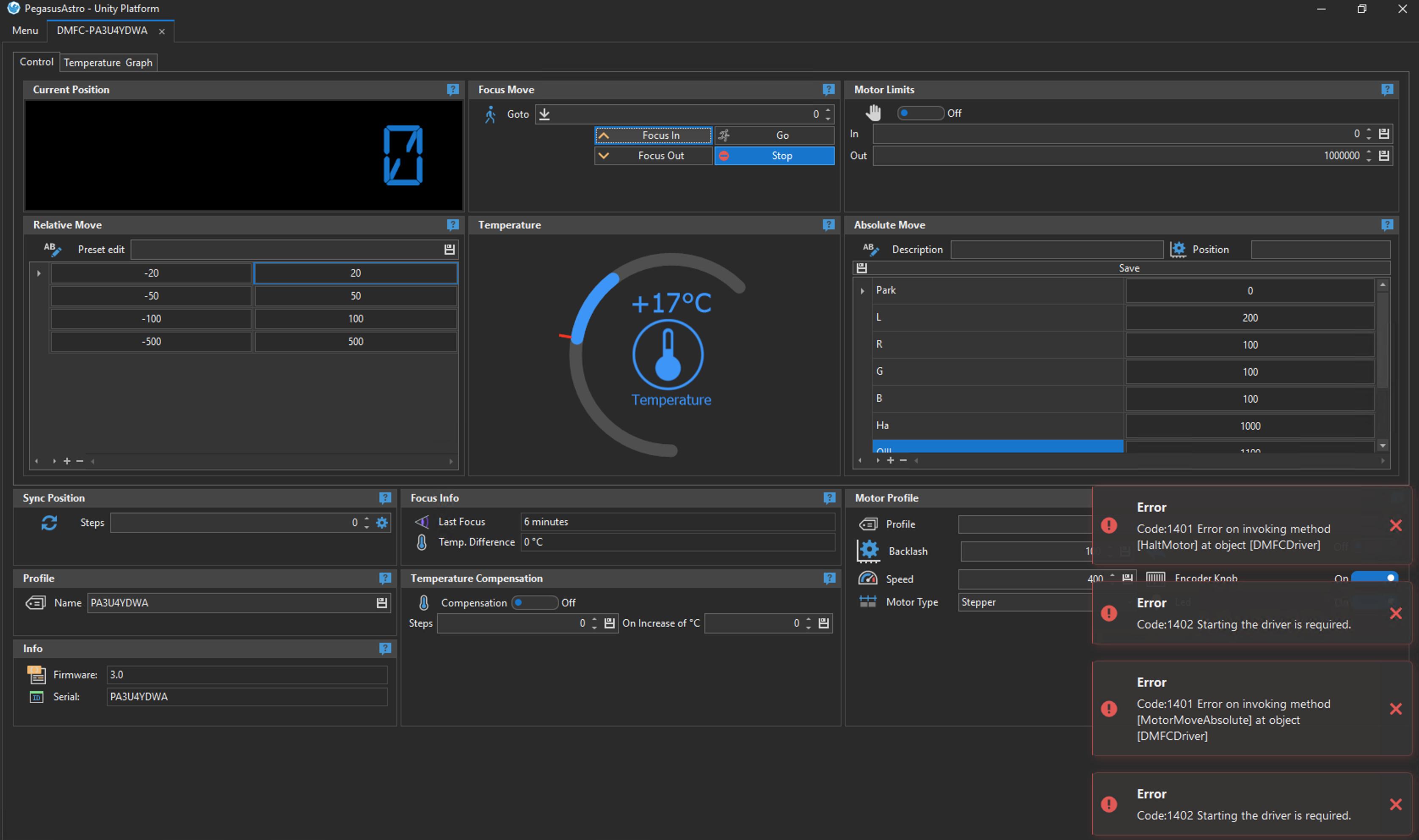

I used a DMFC controller since 2 years with no issue. I recently update Unity and my DMFC doesn't work ...

When I used my DMFC via my PC, it works a little bit then the DMFC disconnect (sometimes after 10s, sometimes 2m, sometimes 10min). I need to power off it to can work it again ...
I've the same issue via Unity or every automation software (NINA, SGP and Voyager). Enclose to this message the errors reports by Unity when DMFC is disconnected ... Times before disconnection looks to be shorter via an automation software than Unity.
Capture d’écran 2023-06-06 à 01.41.57.png (1.13 MiB) Viewed 8876 times
