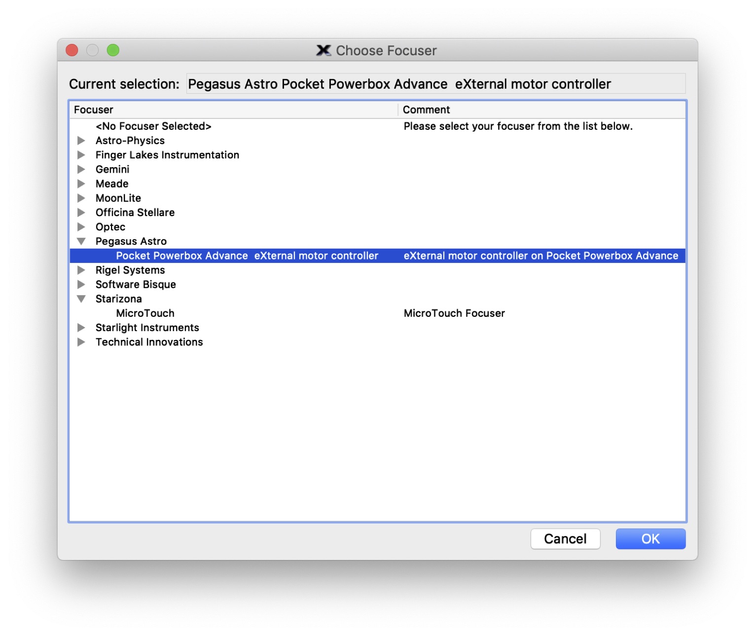

Re: UPBv2 TheSkyX
It is hidden under Focuser driver. Please check the image below

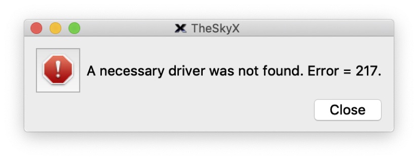

I had installed the PegasusPPBA_X2.pkg driver which is not recognised by TSX "A necessary driver was not found"

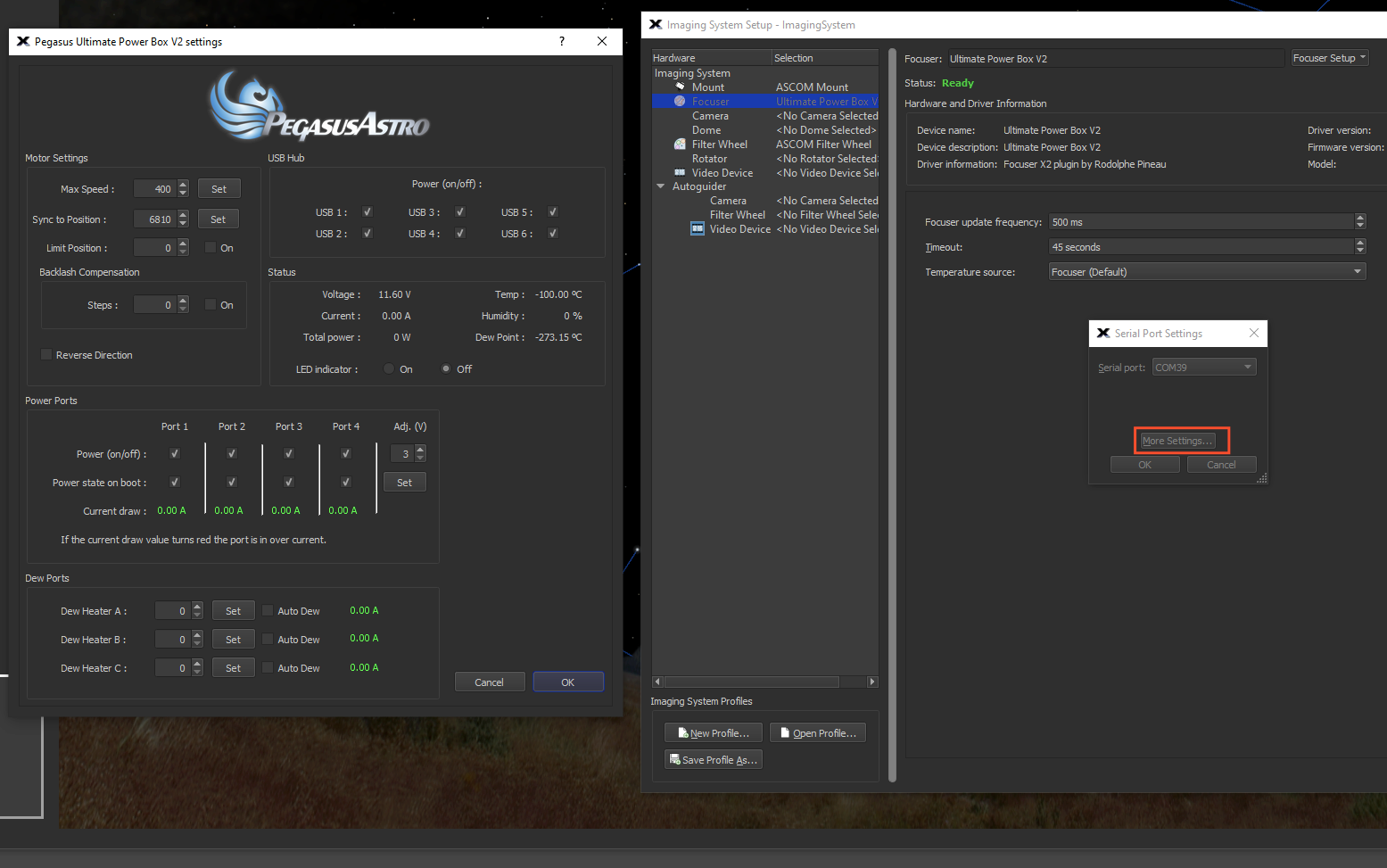

The panel I wish to access to is this one :

The plugin doesn't need any drivers so error 217 means the plugin was not correctly installed (and this could be my fault).

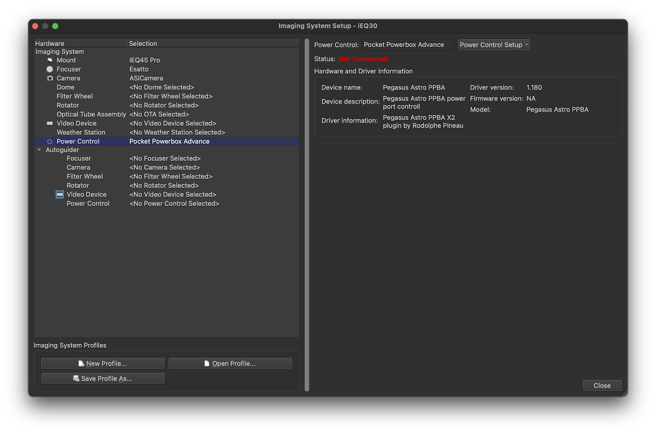

Quick screenshot of where you need to select the device (here it's in the guider config but this also apply to the main imaging train config) :

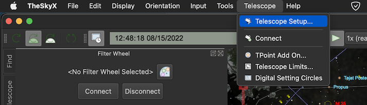

Once the plugin is installed you need to select a power control in theSkyX , like any other devices (this is covered in TheSkyX documentation), the same way you would chose a camera.
So got to Tools -> Telescope Setup :
Screen Shot 2022-08-15 at 12.48.18.png (101.68 KiB) Viewed 20744 times

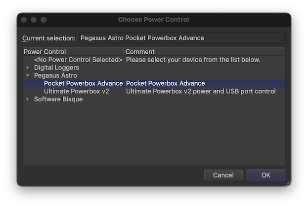

Then click on Power control :
Screen Shot 2022-08-15 at 12.49.53.png (260.69 KiB) Viewed 20744 times

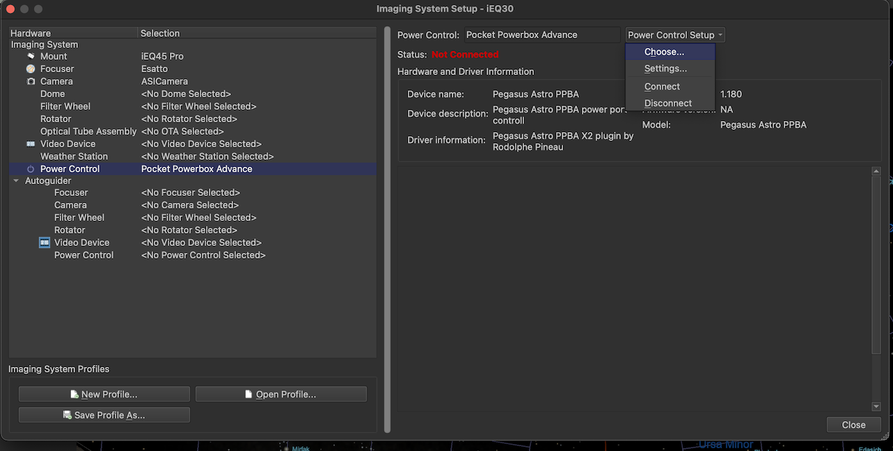

And then Power Control Setup -> Chose :
Screen Shot 2022-08-15 at 12.52.30.png (213.09 KiB) Viewed 20744 times

This will bring the window in which you select the power control device you want to use :
Screen Shot 2022-08-15 at 12.54.07.png (79.34 KiB) Viewed 20744 times

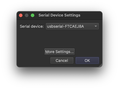

Once selected you need to chose what serial port it's on by clicking on Power Control Setup -> Settings.
Select the serial port corresponding to the Power box , then hit connect.
The main settings dialog is accessible from the Settings -> More Settings :
Screen Shot 2022-08-15 at 12.58.30.png (47.83 KiB) Viewed 20744 times
This will bring the dialog with the specific settings.
Rodolphe

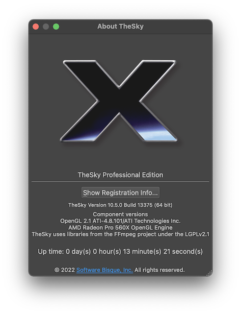

Sorry I missed your post above.. no power settings, which means this is an old version of TheSkyX that has no support for power settings ! Also all my plugin are 64 bits only so that might be why you got the error 217 as you version might be old enough to be 32 bit only.
If you go to TheSKyX -> About TheSkyX, this brings the about window where the build number is shown :
Screen Shot 2022-08-15 at 13.01.08.png (16.27 KiB) Viewed 20744 times
Screen Shot 2022-08-15 at 13.01.12.png (145.06 KiB) Viewed 20744 times
