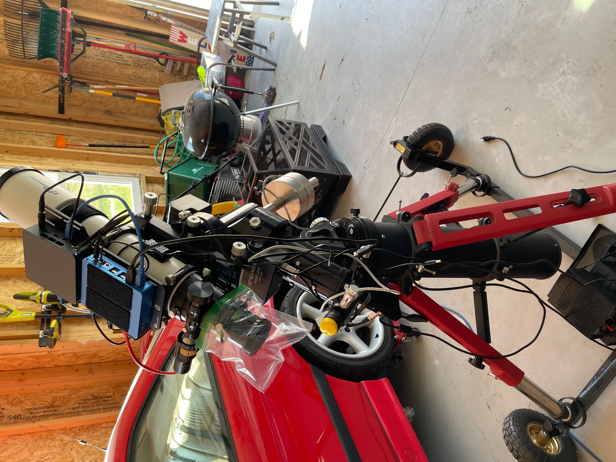

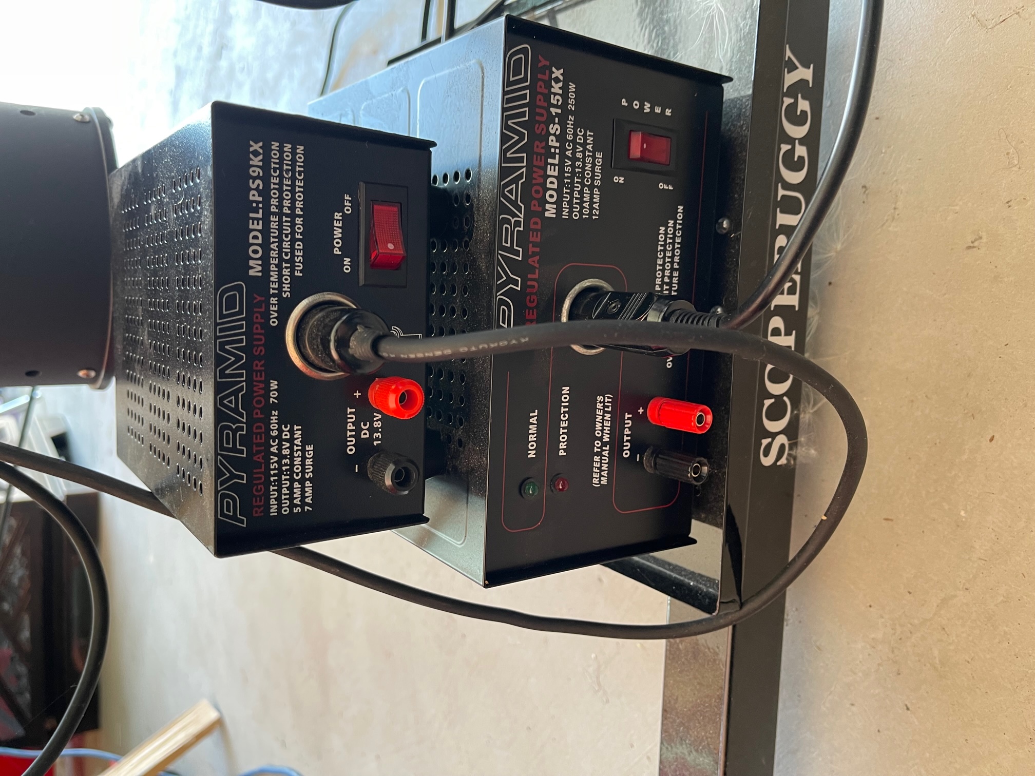

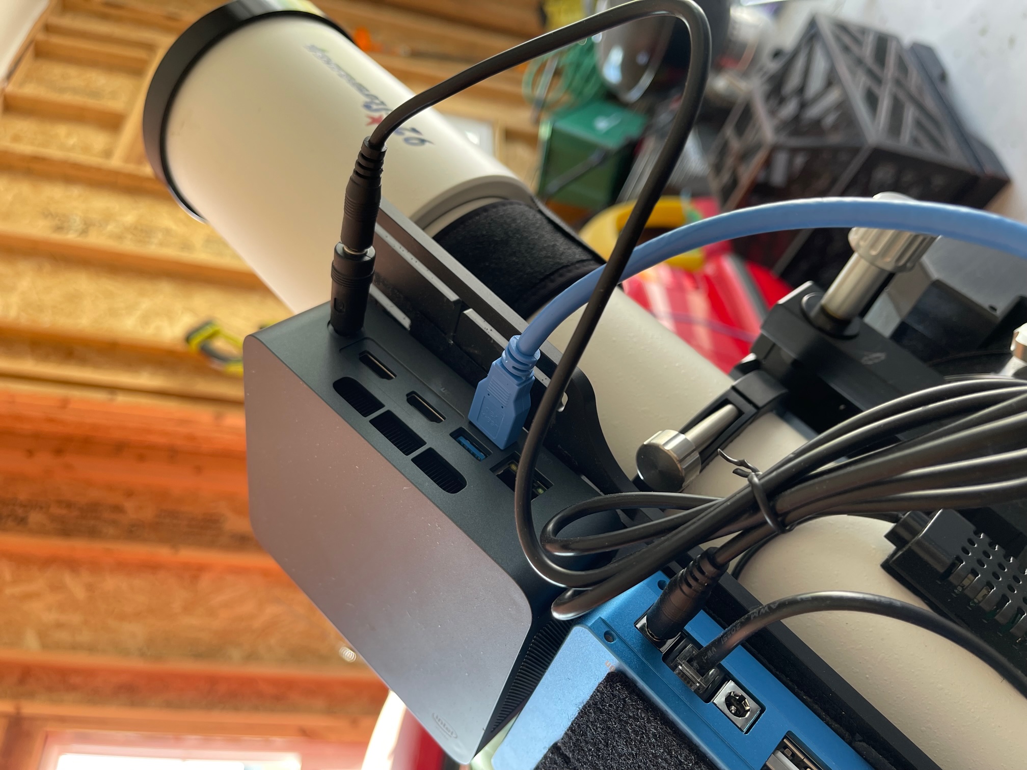

I appreciate the detailed response. Just for clarity, I only loose power to my mini pc, everything else maintains power that is connected to pegasus box. I am using the 12v output from the Pegasus to the mini pc which is the power cable supplied by Pegasus and the distance is less thanks 6”. I am using two separate pyramid dc power supply one is dedicated to my AP mount and the 10amp one is dedicated to everything else. I am using the supplied Pegasus power cable to go to the pyramid power supply which maybe 5feet. The pyramid power supply plugs into an extension cord that is approximately 50ft away from my plug in the garage. That extension cord is rated for 10amps.
- I find it strange that I am only loosing power to the mini pc
- the Pegasus box and everything else plugged into it still has power
Hope this makes sense.
thanks again for the suggestions
