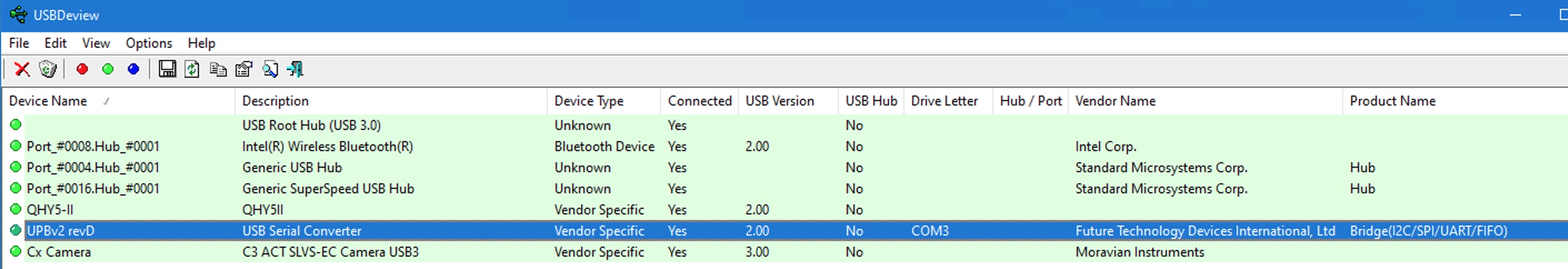

I've replaced the cable running from the UPB to the imaging PC, using the one provided by Pegasus, to no avail.
One thing I found curious: the FTDI driver is registered as an USB 2 device, not USB 3, see screenshot below - could it be the source of the problem?
