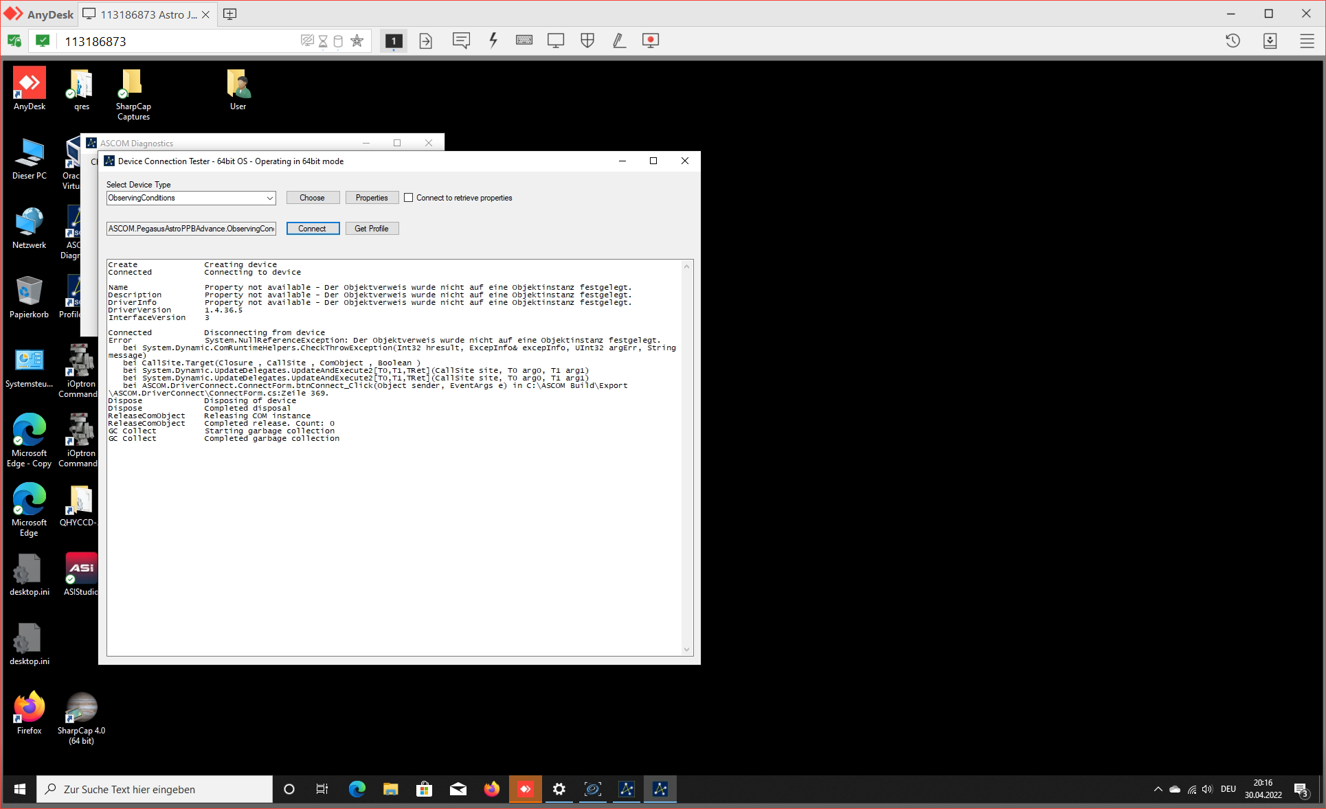

i can confirm the same connection issue exits for the PPBA Gen 1 with NINA 2.0 RC01. While the PPBA connects to the Unity App without problem it suffers to connect to NINA or the ASCOM Diagnostic Tool. See attached Screenshot
- 2022-04-30.png (266.31 KiB) Viewed 7626 times
