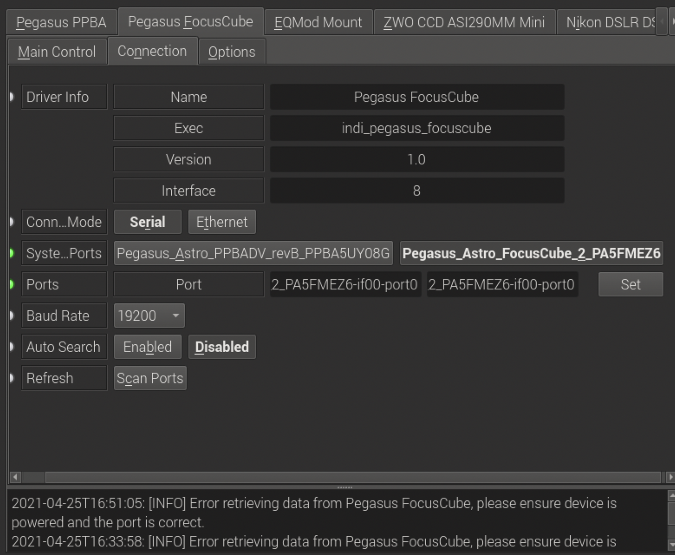

I 1st purchased the Pegasus Pocket box Advanced in which I had no INDI issues.
I later picked up the Pegasus Focus Cube 2 which has created a port conflict in INDI.
Rarely do these devices both connect together.

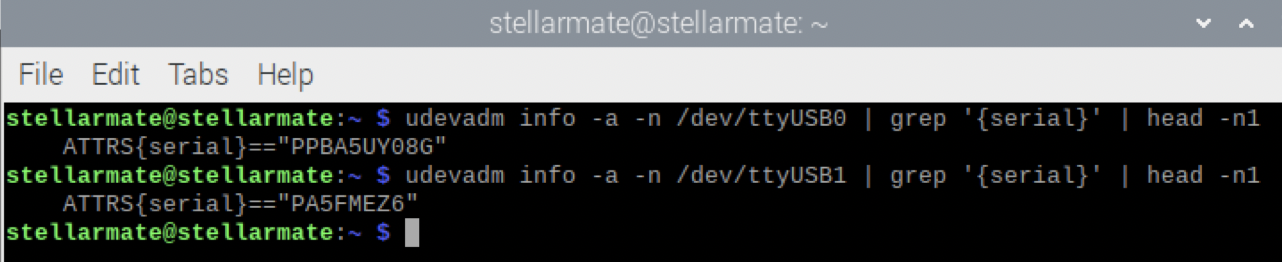

When looking in the Raspberry Pi terminal window I can see that the Pocket Box occupies USB0 and the Focus Cube occupies USB1, yet together they most of the time cancel each other out.
Below shows that they reside on different USB port assignments.
(Removed image as it repeated 3 times: On request I might try sharing this later)

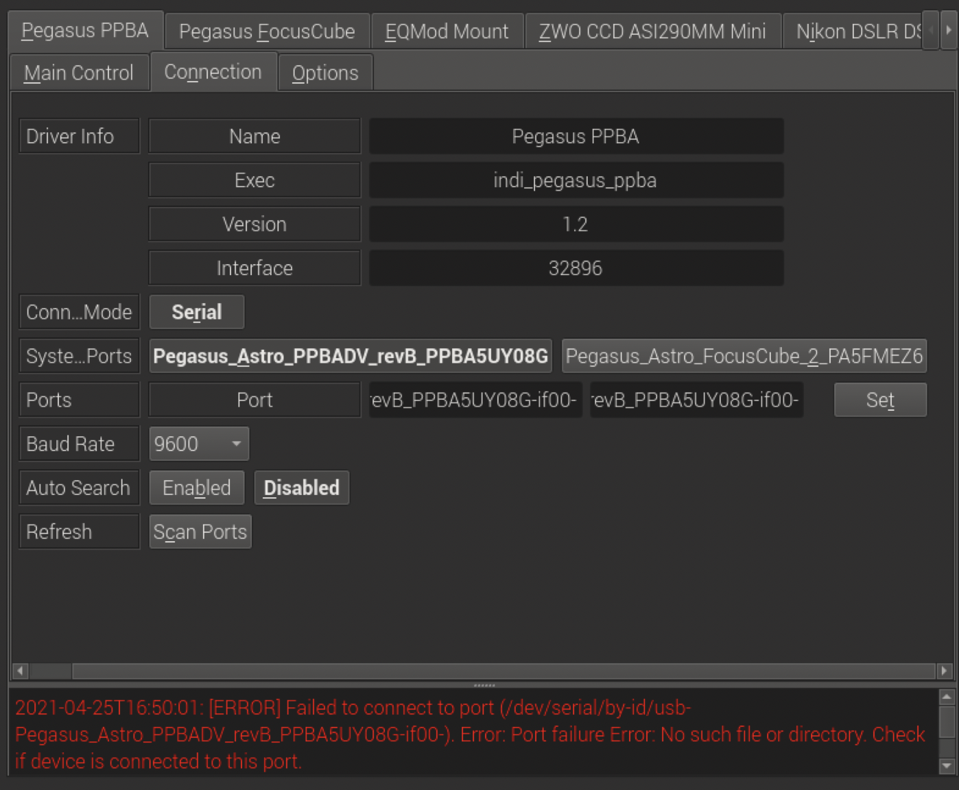

Yet when I try to connect them most of the time they show a port conflict as below.
I've struggled with this issue now for over a month and it is getting very frustrating.
Can you assist me in any way in identifying the issue and the possible solution?
These are both serial devices.
The error messages make me think that something about them might be too similar and it creates confusion with a port search that locks both devices up from being connected.

- PPBA connect.png (720.37 KiB) Viewed 12661 times
- Focus Cube connect info.png (713.75 KiB) Viewed 12661 times
