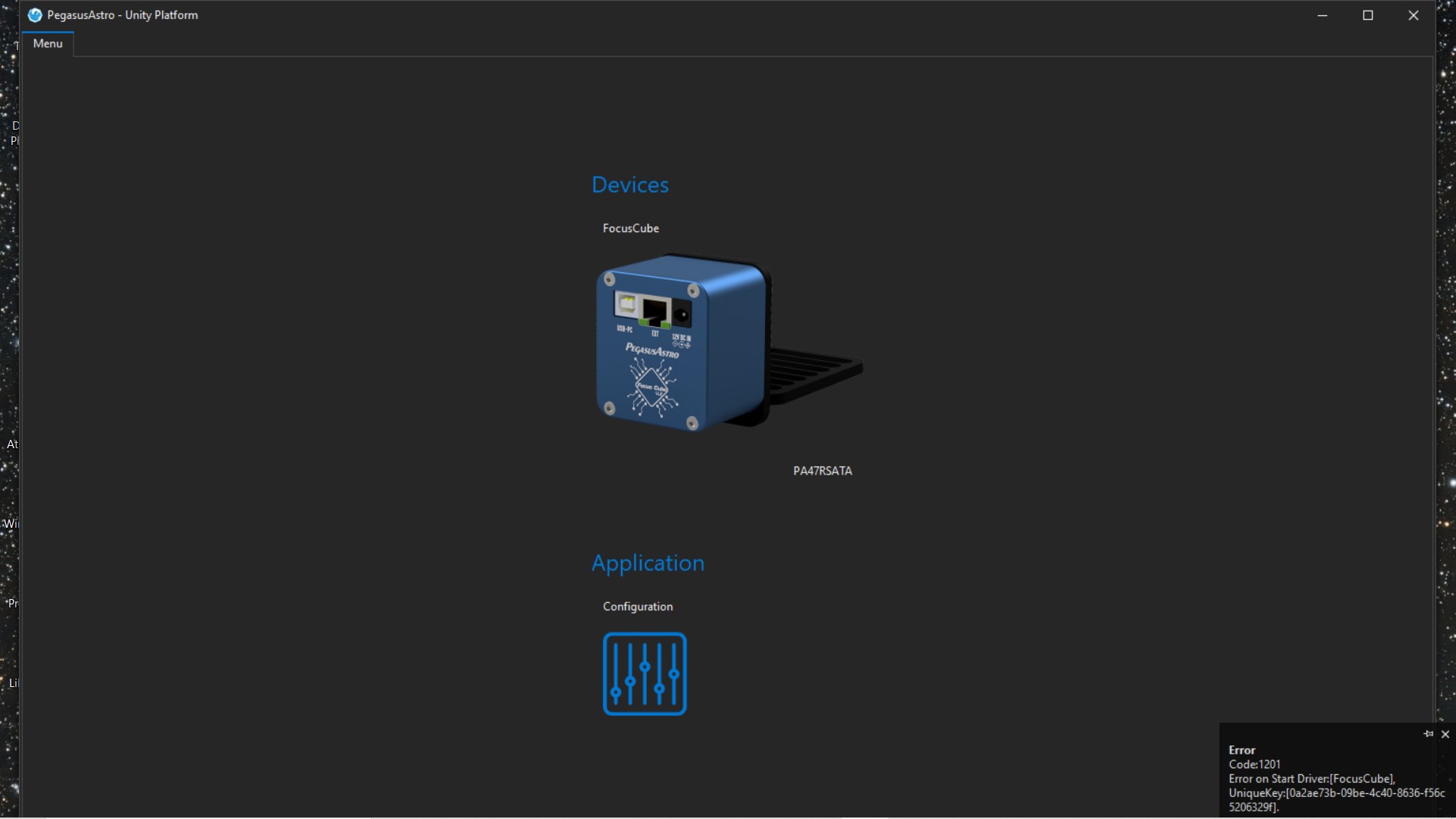

Hello everyone,
I recently acquired a FocuscubeV2 for my 80ED refractor.
ASCOM 6.6 has been uploaded, along with Unity Platform 1.4.1.1.
Windows 10 is up to date.
The equipment is powered by a 12 volts 7 amp power supply, and connected with the original USB2 cable.
Unfortunately I cannot connect the motor correctly : display of an error code "1201" Error on Start Driver (see screenshot).
What did I forget or do wrong, please ?
Trouble connecting my FocusCube V2 ...
Re: Trouble connecting my FocusCube V2 ...
Continuation and additional informations :
- My dealer checked the FocusCube (under warranty) on his own equipment : it works perfectly !
The problem therefore comes from my computer system.
- I tried to uninstall then reinstall the Unity Platform software, without success.
Ditto by stopping my antivirus.
- I tried to connect the Cube to my old PC under Windows 8.1: same result with still this error 1201 !
On the 2 PCs (Windows 10 and 8.1), when I plug in the USB2 cable I hear a connection sound, then the image of the cube appears in Unity ;
I get error code 1201 when I click to access the engine.
10 seconds later I have a disconnection sound and the image then disappears !
This cycle repeats itself indefinitely...
- Also tested to change power supply : on battery, same failure.
With my weak skills I conclude to a problem with the FocusCube driver which does not seem to start correctly ?!
But why ?!!
I've come to the end of the possible solutions, I've run out of ideas !
Please help me, if anyone has a genius idea !

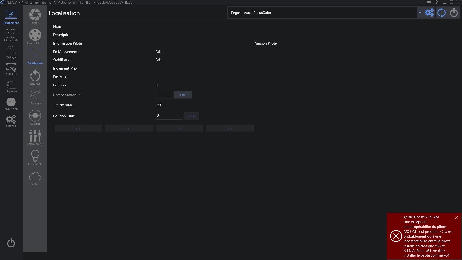

Hi Thomas,
Thank you very much for your feedback.
I uninstalled Unity Platform, and I no longer have the 1201 error.
But it still doesn't work, with a new error which confirms that the problem comes from the driver (see screenshot).
Translation : "An ASCOM driver interoperability error has occurred. This is probably due to an incompatibility between the driver being installed as x86 and NINA being x64. Please install the driver as x64."
I will work in this new direction by reinstalling everything from the beginning !

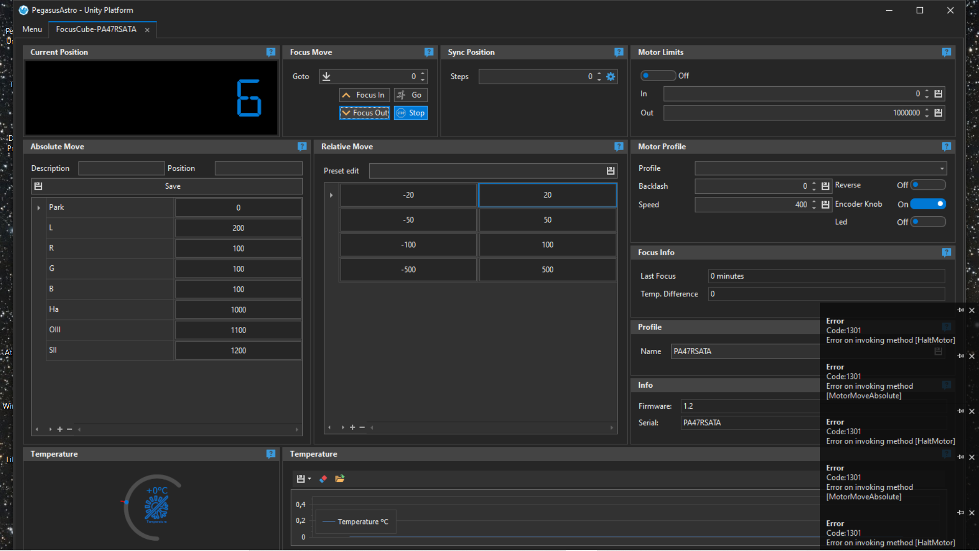

Hi !
A lot of work this spring which did not allow me to progress on this problem.
But this summer I took part in a gathering of amateur astronomers: a participant also owning a Focus Cube tried mine on his PC: after a good hour of searching, failure to connect my Cube!
Today I reinstalled Unity Platform and, finally, I move forward:
the engine has taken its first steps!!!
Only 6 (see screenshot), but that's a lot of progress for me!
New error message, anyone have any idea?!
